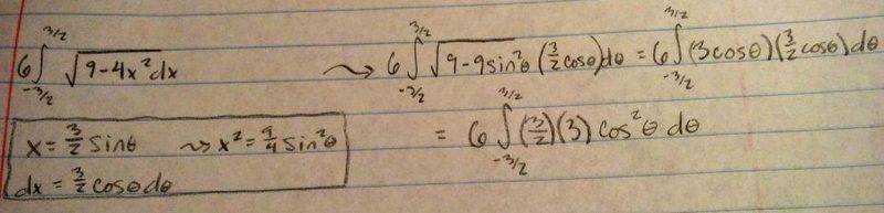

Alright I posted some of the work but I'm having trouble with the dx and d(theta).
  • Handwritten trigonometric substitution work on lined paper: integral from -3/2 to 3/2 of 6 sqrt(9-4x^2) dx, rewritten with x = (3/2) sin(theta), dx = (3/2) cos(theta) d(theta), and a new integral of 6 times 3 cos(theta) d(theta).
You haven't substituted correctly for dx .
Also you need to now change the limits of your integral .
Forgot to change the limits but I think I correctly included dx as d(theta)
  • Handwritten calculus work on lined paper: integral from -3/2 to 3/2 of 6 times the square root of 9 minus 4x squared dx, rewritten with x = (3/2) sin theta and dx = (3/2) cos theta d theta, then 6 times the integral of 3 cos theta d theta.
You are supposed to substitute dx by (3/2)×cos(θ).dθ
Sorry added the wrong pic
  • Handwritten trigonometric substitution on lined paper: 6 times the integral from -3/2 to 3/2 of the square root of 9 - 4x^2 dx, with x = (3/2) sin θ, x^2 = (9/4) sin^2 θ and dx = (3/2) cos θ dθ, rewritten as 6 times the integral of (3 cos θ)(3/2 cos θ) dθ.
So now just change your limits and you will get the answer .
