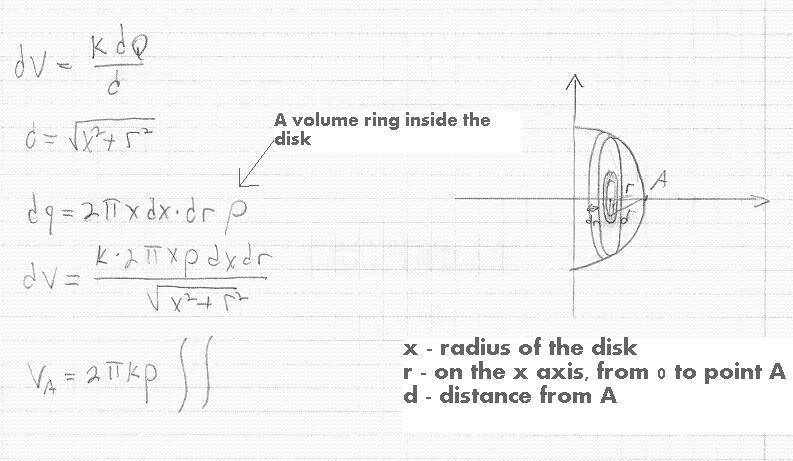

Hey guys.
So I've got half a ball from 0 to point A as you can see in the pic and I need to calculate the potential of the ball at point A.
So what I did is to break it into disks.
I found the differential potential of a volume ring which is inside the disk at point A and now I need to sum it up.
I know that I need to take r from 0 to R, my problem is with x, what are its limits? I mean it keep changing from disk to disk.
I hope the problem is clear.
Thanks a lot.

Calculate what potential? Gravity, electric potential of a uniform charge distribution in an insulator, on a conductor ... What are you trying to do?

... and it's an insulator with uniform volume charge distribution perhaps? Or is it a half conducting sphere?

Well, it's half a sphere with a uniform volume charge distribution (p). I used it in the formula.

I would figure the integrals separately to avoid confusion, doing first the disks and then summing the little disks along the x-axis.
The radius of each little disk is (R² -x²)1/2 such that at x = 0 the circumference of the rings are 2π*R and that distance from around the rings to A is ((A-x)² + y²)1/2.
You would integrate that y from 0 to (R² -x²)1/2. I think that should give you the disks, that you then can integrate in x from 0 to R.
I understand you can express it all as a double integral directly, but I'm a slow guy that likes to keep things straight.
