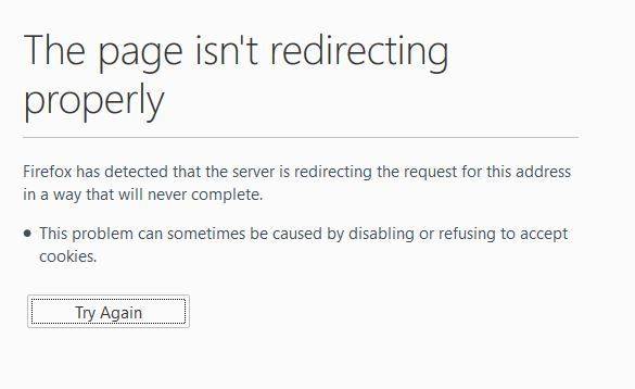

Attached is the error message. Should I call Linksys?
thanks
No, at least not yet.
The most likely things are:
1) Your browser(s) are set to refuse cookies
2) An Ad blocker you are using is configured to block a site that the Digikey page wants
3) The Router is configured to block a site that the Digikey page wants
4) There is an error on the Digikey page
For further troubleshooting, on the desktop machine, disconnect its network cable from the Router and plug it into the Modem. If the problem is cured then the Router is causing the trouble (misconfigured?).

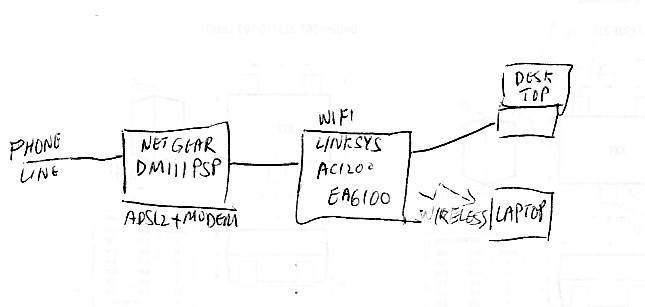

Thanks for the reply. I attached the drawing of the network connection of my system. The phone line goes to the Netgear DM111PSP, a ethernet cable connects from the Netgear to the Linksys. The desktop connect to the Linksys by ethernet cable. The laptop connect wirelessly to the Linksys.
I tried plugging the desktop directly to the Netgear bypassing the Linksys. It still failed. So the Linksys is not the problem. The problem can only be either with ATT or the Netgear.

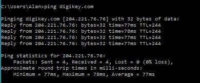

Try typing ping www.digikey.com into a command window. If it says "Reply from number.number.number.number: bytes=32 time=number TT:=56" there is nothing wrong with your internet connection and the problem is your browser.

I type "ping digikey.com" attached is the reply in cmd. I think it's replying ok. I typed 204.221.76.76, I reach the front page of Digikey. I can always get that, it's the second step that fails. I can click anything on the manual and it will not work.
Thanks

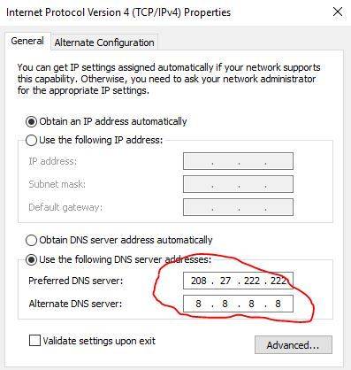

Problem solved. A friend on mine suggested changing the DNS server. Works like a champ.
Thanks
