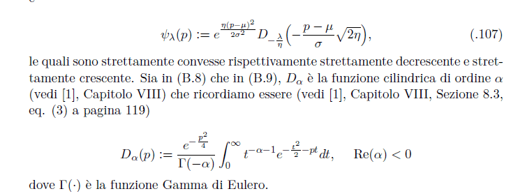

Hi, I have to solve one equation on Matlab. The equation is: (p-c)*psi'-psi=0 I have to find p. Where psi is:
Typeset mathematical text defining psi_lambda(p) as an exponential times a parabolic cylinder function D of order minus lambda over eta, numbered equation (.107), followed by a definition of D_alpha(p) as an integral from 0 to infinity with Gamma(-alpha) and the condition Re(alpha) < 0.
and psi' is the derivative of psi. I've written this code:

I've calculated the derivatives by myself, and I hope they are ok. What do you think about the code? It works only if rho>eta. Moreover for different values of sigma it give me some strange results.
Do you think the code is right and the derivatives are correct?
