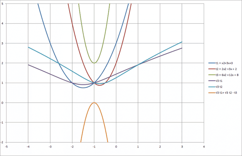

To be honest, I have no idea how to deal with this kind of equation analytically, and I can't follow your first step (*), so I simply plotted the terms and I see that only -1 is a solution.
Multiplicity is 2, also from visual inspection.

I have a very strong suspicion that your equation cannot be solved "analytically" in any easy way, so if I were trying to do it the very first thing I would do is plot the functions. That reveals x = -1 as a double root (a fact that can be verified analytically, once we know what we are looking for). That is how I would normally do it if I did not know about x = -1 ahead of time.
