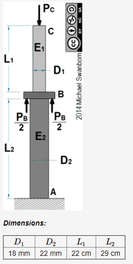

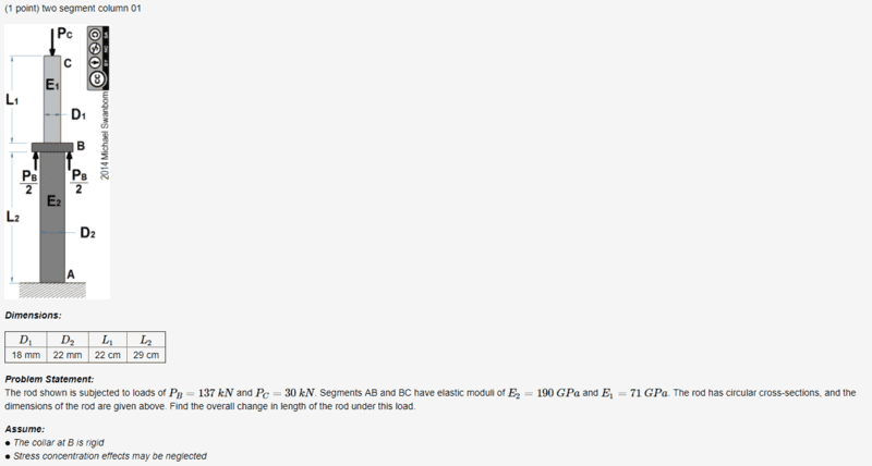

deformation=(force*length)/(elastic moduli*area)
and
since most of the variable are constants it seemed like a simple plug in problem, however it seems that my use of the forces is incorrect. unfortunately we had no examples for this chapter in class and what is in the textbook has not helped me so far. the above is both equations for deformation of each rod summed together top rod first then bottom.
