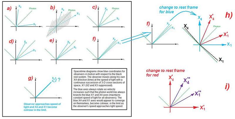

Hi, KrisOhn
Here is a sequence of spacetime diagrams that kind of picture the situation. First, in the upper left box of diagrams, I just try to emphasize the way in which a pair of x1 and x4 coordinates are oriented for someone moving at relativistic speed with respect to the black rest system. The sequence in the left box shows blue systems corresponding to moving with higher and higher speeds relative to black.
But now we show in the right side sequence of sketches that you can simply present the situation from the point of view of one of the blue guys (from sketch f), that is, you now show the situation in the rest system of the sketch f) blue guy and add in another red guy who is moving even faster with respect to the original black coordinates than the blue guy was (see sketch h).
But, even after that, you can show the situation in the red guy's rest system and add in yet another faster moving purple guy (see sketch i). And you could then show the situation with the purple guy's rest system, then add in someone going even faster with respect to him---and on and on ad infinitum (as long as you don't try to have one of them going at light speed).
