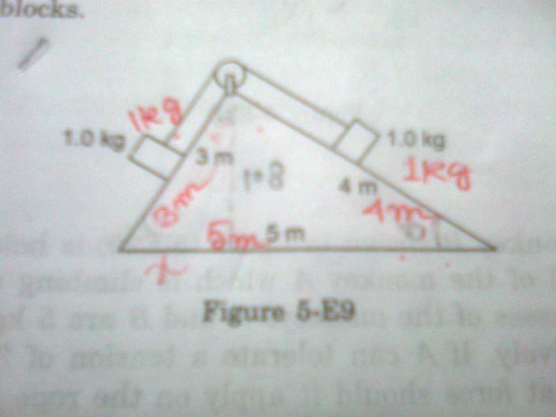

in the given diagram all the stings and pulley are mass-less ad there is no friction calculate the magnitude of acceleration of the two blocks?
the acceleration of the blocks is obtained by me to be g/20 but the answer is g/10.my attempt at the problem is given on the other image. i have vied hard for it , so please help me.
  • Photo of a textbook figure, Figure 5-E9: two 1.0 kg blocks on opposite sides of a triangular wedge, joined by a string over a pulley at the apex, with the wedge sides labelled 3 m, 4 m and 5 m and handwritten red annotations.

g/10 is the correct answer. You must have done something wrong, but we can not help unless you show your work. ehild
