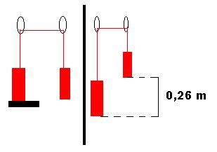

Two bricks with mass = 1,0 kg and 1,5 kg is tied together with a thin line going through two rings (with no friction). First, we hold the heaviest brick up so that the two bricks hang still at equal height. Then we'll remove our hand so that the bricks start moving. What is the velocity of the bricks when the lightest brick is 0,26 m higher than the heaviest brick?
Tried to illustrate it, but I'm no good with Paint. But hey, I tried :) Hope you get something out of it.

A good way to start would be to consider the forces acting on each brick and then apply Newton's second law to each brick individually.
Ignore the pulley for now and just imagine a falling block.
What do you know about the accelaration of a falling object?
What equation links time / speed / accelaration ?

Okay, you've got the right idea but are making a few small slips along the way. Let's do this step by step.
Intuitively, in which direction will the system move? In other words, which block will move upwards and which block will move downwards? We shall take this direction as positive.
Now write down the sum of the forces acting on each block, taking note of the direction. If the force acts in the same direction as the block is traveling then the force should be positive. Otherwise, the force should be negative.
