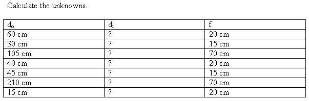

I have to complete a chart using the thin lens formula. Can someone please help me out? I know that the formula is 1/f= 1/do= 1/di, but I don't know how to use it.
Thanks.

yeah, I know that, but how do I find the uknown?

I don't know what is unknown (if that makes sense :biggrin: ). You haven't specified an unknown.
Sorry I didn't say it, but I attached a chart :-p

I'm afraid I can't see your chart as it is yet to be approved by a mentor.

oh okay then I'll just type it here
do di f
60 cm ? 20 cm
30 cm ? 15 cm
105 cm ? 70 cm
40 cm ? 20 cm
45 cm ? 15 cm
210 cm ? 70 cm
15 cm ? 20 cm​
Something that has just occurred to me, you have written down the thin lense equation wrong. You written;
1/f= 1/do= 1/di
It is actually;
[tex]\frac{1}{d_{o}} + \frac{1}{d_{i}} = \frac{1}{f}[/tex]
Sorry I didnt spot that sooner.
~H
lol oops... I typed it out wrong, but I still don't know how to use it :cry:
Well, you are given two variables (do and f). Just re-arrange the formula to find 1/di, then find the reciprical.
