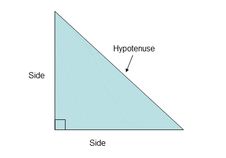

Now, I drew the triangle and found that the vertical side is 10ft, the horizontal side is b ft and that's all i know! How am I supposed to find anything knowing only 1 side?

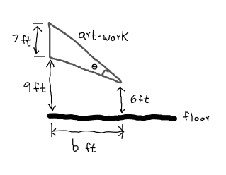

Hi, the prof tried to give us a hint and drew the picture for us! The triangle in question is apparently NOT a right angled triangle:confused: and i am now thoroughly confused:cry:
Hi AnnaSuxCalc! :smile:
Yes, you are!​
If the top and bottom of the picture are T and B, and you are U, then the prof is correct … the angle is BUT …
so that's the triangle the prof is talking about …
but you don't know two of the sides of that triangle, so you have to follow HallsofIvy's :smile: plan and draw the triangles BUF and TUF (where F is the floor), and find the angles BUF and TUF. :wink:
