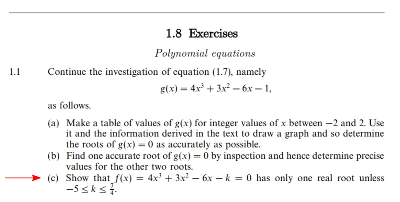

Statement of the problem :
Let me copy and paste the problem as it appears in the text. [Riley, K.F., Hobson,M.P., Bence,S.J. (2006) Mathematical Methods for Physics and Engineering. (3E)].
Attempt : One real root is guaranteed, as ##n =\;\text{odd}##. Differentiating ##f'(x) = 12x^2+6x-6=6(2x-1)(x+1)##. Thus ##f'(-1) = f'(1/2) = 0##. Hence, the derivative ##f'(x)## itself has two real roots, which indicates that ##f(x)## may have three real roots.
To test whether it does, we use condition (4) in the Relevant Equations section, given above. Namely, evaluate the value of the function ##f(x)## at those two values where its derivative vanishes to see whether they are of opposite signs, i.e. whether ##f(\beta_1)f(\beta_2)<0##, where ##\beta_1 = -1,\;\beta_2=1/2##.
##\small{f(-1) = 5-k\;\text{and}\; f(1/2) = -7/4-k\Rightarrow (k-5)(k+7/4)<0\Rightarrow\boxed{\color{red}{-7/4\le k\le 5}}}##.
Text answer : This is different from the answer in the text, where ##\boxed{\color{blue}{-5 \le k \le 7/4}}##.
The text answer is correct, as I could verify at ##\verb|desmos.com|##.
Request : A hint as to where am I going wrong in my working.
Many thanks.
Your working appears to be correct, and I obtained the same result by considering the discriminant of ##f##.
What did you do to verify the text answer? According to the text, for ##k = -3##, ##f## should have more than one real root, but according to Wolfram Alpha there is only one real root and a complex conjugate pair.
I must therefore conclude that the text answer is incorrect. It happens.
EDIT: It is a bit strange to have a minus sign before the ##k## in the problem statement, so maybe that was meant to be a plus sign, which would make the answer in the text correct.

Hi @pasmith, yes it seems I was mistaken too in my plotting on ##\verb|desmos.com|##. I took the constant ##k## with a positive ##(+)## sign.
Of importance is the minus ''##-##'' sign before the term ##k## in the question, as you pointed out. If it was ##+k##, then the book is correct. As it stands, it's mistaken.

It may be an error in the book solution. Can you point to what page of which edition you find this problem?
I copy and paste the problem to the right of the screen. Please look at part (c) where, we believe, the error has taken place in what we are seeking to prove.
This is the book, complete with its author(s) and edition :
Riley, K.F.; Hobson,M.P.; Bence,S.J. (2006) Mathematical Methods for Physics and Engineering. (3E) (page 36)
I must warn that this is a low-price edition, affordable for people in the third world where I live. They are always in paperback and the pages are of an inferior quality - not the glossy type that westerners are used to. The original (hardcover) edition might have different problems! [I know for a fact that a different book, Sears and Zemansky's University Physics, actually had different problems in their low-price edition for third world countries as against those in the originals (courtesy Pearson)]
pasmith said:
EDIT: It is a bit strange to have a minus sign before the k in the problem statement, so maybe that was meant to be a plus sign, which would make the answer in the text correct.
Seems likely to me that there's a typo in the book's problem statement, like @pasmith notes. Typos in published answers happen even in higher-priced editions.
Could be an error in the sign of "k", but here is the hint:
(c) −5 and
4 are the values of k that make f(−1) and f(1/2) equal to zero.
from book page 39.
##f(-1) = 5\pm k = 0 ## so ##k =\mp 5## so it looks like an error in the author's logic (the problem starts with -1 then switches at point c) to -k and the authors mean ##k =1##.
