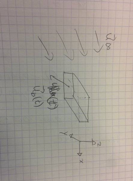

Oh yes sorry, it is about cooling a block which moves which a certain velocity. There is a flow going over the block. The textbook in question is 'heat and mass transfer' from Cengel.

So a block moves with a certain velocity (dependent on time). There is a free stream going around the block which cools it. I am interested in the temperature distribution of the block. This is a 3D unsteady heat conduction problem with convection boundary conditions. For convection boundary conditions a heat transfer coëfficiënt is needed. For determining a heat transfer coeffcient, the Nusselt number is needed and that is related to the Reynolds and the Prandtl number. The relations given in the textbook by solving the boundary layer equations, but is assumed that there is steady, incompressible and laminar flow. However these assumptions are not correct for my case. How should I proceed? Thanks in advance. (See also the picture).
  • Hand-drawn sketch of a rectangular block with a free stream arrow U-infinity approaching from the upper left, a labelled block velocity U_b(t), and x, y, z axes at the lower right.
The first step is to convert this from a 3D problem to a 1D problem. Is the block you have shown in the sketch roughly to scale? If so, suppose you assume that the slab is of infinite width (rather than finite width). And suppose you can assign an approximate constant average value to the convective heat transfer coefficient on top and bottom surfaces, rather than one that varies along the length of the block. Now you have a 1D problem for a slab of finite thickness, with a convective heat transfer coefficient at the larger surfaces. Incidentally, what is the boundary condition at the bottom surface?
