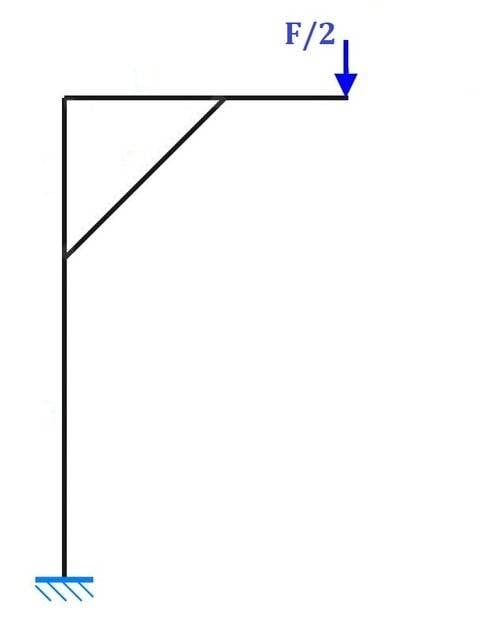

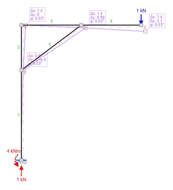

Hi,
I'd like to find the easiest way to solve the following braced portal frame statically (at least for deflection and maybe stress if possible, no need to account for buckling here - reason explained below):

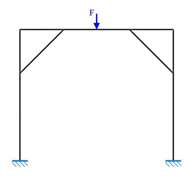

Of course, I could utilize symmetry:
But the problem is still that it's a statically indeterminate structure with a quite high degree of static indeterminacy - I assume no pinned joints.
Now the purpose is just to verify the results of the open-source FEA benchmark (so it's not an actual engineering case or homework). Thus, I will use FEM but I need an analytical solution as well. I was looking for ready-made formulas for such frames in books like Roark's but haven't found anything. Are you aware of such publications ? Those frames seem to be pretty basic after all.
If there are no ready-made formulas, I'm considering using some simplifying assumptions to make it easier. So maybe assuming all pinned joints (I wonder how inaccurate this assumption would be) or even solving the members one by one as individual beams but I'm not sure how to approach that. I'm aware that otherwise likely the only way would be to use the force or displacement method which is not easy and I don't have a civil engineering background.

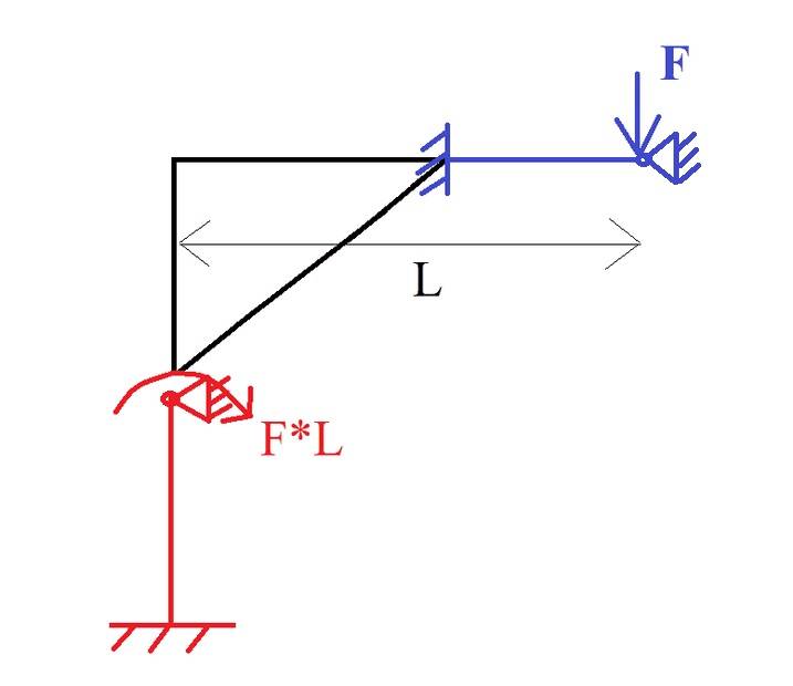

I would treat the braced sections as a non-deformable plane, which only function is transferring forces and moments among the columns and the beam.
Those two planes will suffer some rotation, induced by F and its moments.
Therefore, the ends of the beam and the columns connected to those planes will bend, following the planes rotation, until equilibrium is reached.
This example may help you initiate your hand calculations:

Thank you for the reply. Do you mean something like this (assuming that I will only consider half of the frame, also because it's interesting by itself - could represent a workshop crane) and solving only the red and blue beam ?

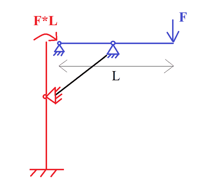

I'm also thinking about treating just the brace as rigid:
But I'm not sure if it makes sense.
As a result, I will mainly need the deflection of the point loaded with F.
The actual deflection will look like this:
The problem is that the energy of F must deform the whole structure within its geometric limits, which includes making a happy face of the horizontal beam and pushing the top ends of the columns out (harder to do than the represented deformation in your diagram).
It does, but the read support will have to be freed to also move horizontally some to the left.

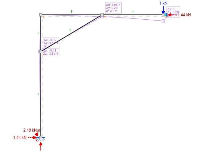

Symmetry between the two anchored ends of the columns must exist for a centered punctual load.
Please, revisit the approximate deformation shown in the diagram of post #2 above.

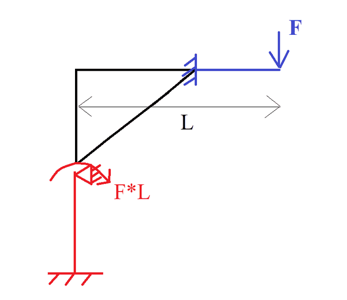

@Lnewqban I updated my diagrams to include what you said plus the symmetry condition that I forgot about (although I'm still considering using this for the workshop crane problem where there would be no symmetry). What do you think about those 2 modified approaches? The problem with the updated first approach is that the column is not stiffened by the brace. With the second one - that I'm not sure if I can find deflection formulas for vertical roller support. But it should be essentially half of a double cantilever beam, right? Or maybe I should treat it as half of a simply supported beam...
