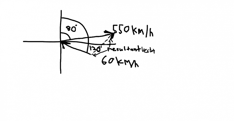

Please draw a vector diagram to show exactly what you are talking about.
physics4ever25 said:
OK. This is the picture I envisioned. Now, do you know how to resolve these vectors into their components in the x and the y directions? If so, what are the x and y components of each of the vectors?
Hi, I actually don't know how to do that since I never used that method where I divided the vectors into their x and y components. As you can see in the picture, there's one triangle, so at this point what I would do is simply find the magnitude of the resultant by using the cosine law. That would be as follows-
r^2=60^2+550^2-2(60)(550)*cos40
r^2=306100-66000*cos40
r^2=306100-50558.93
r^2=255541.07
r=505.51
Therefore, the magnitude of the resultant would be 505.51 km/h. This, of course, is according to this method. Using the other method (which I showed in my initial post), the magnitude of the resultant came out to be 597.2 km/h. That's what my confusion was. The two methods give me different answers. When I checked online, some sources showed that the answer was 505.51 km/h (as found by method 1) and some sources showed that the answer was 597.2 km/h (as found by method 2). So, apparently both answers are right.

I get an angle between the two vectors of 140 degrees if I place the vectors tail-to-tail.
If I take the components of the two vectors in the x and y directions, I get:
Plane:
x component = 550 cos 10
y component = 550 sin 10
Wind:
x component = - 60 cos 30
y component = 60 sin 30
What do you get for the resultant x component?
What do you get for the resultant y component?

No both can't. That is the confusion. When I was checking for the answer online, I was finding both answers (550.51 km/h and 597.2 km/h), and that really threw me off.
The 597.2 gives the magnitude of the difference between the two vectors. This is what I get when I use the 140 degrees, laying the vectors tail to tail. The 505.51 (which is the correct answer) gives the sum of the two vectors. This is what you got when you used the 40 degrees, which is consistent with laying the vectors tail to head to add them. Doing the problem in terms of the components gives the resultant of the two vectors as 505.51 also. So the 597.2 is the incorrect answer.
I actually just asked someone about this and they said that there was an error made in the following solution:

The error was the "120" degrees in the initial statement "=[550(cos80+i*sin80)] + [60(cos120+i*sin120)]." That 120 degrees should have been 300 degrees. The reason being, due to the context of the question, wind is considered a back bearing since it says in the question "the wind is blowing at 60 km/h FROM a bearing of 120 degrees." Due to the term "from" used in the question, that means wind is considered a back bearing. For that reason the back bearing formula would be applied in this case: back bearing=(180 degrees+bearing)=(180+120)=300. Therefore, the 120 in the formula should be replaced with 300. When I do that the answer works out to be 505.50 km/h. The proper solution can be seen below:
____________________________________________________________________________________________________________________________________
Vr=Vp+Vw
=[550(cos80+i*sin80)] + [60(cos300+i*sin300)]
=[95.50+541.64i] + [30-51.96i]
=125.50+489.68i
Since this is in a+bi form you will now convert it to polar form. You will do this using the Pythagorean theorem and tan.
r=square root (125.50^2+489.68^2)
=505.51
TanTheta=489.68/125.50
Theta=75.63

This is what I get doing the problem in component form.
Chet
Chet
Can you explain a bit about the whole "back bearing" concept I mentioned. I'm a bit confused about when to use back bearing. In the case of the plane vector in the question, the forward bearing was used, and in the case of wind vector in the question, the back bearing was used.
The key words are "blowing from." That means that the wind is blowing from the 120 degree direction. You have correctly shown the wind direction in your diagram.
So whenever it says "blowing from" I use the back bearing for that formula (method 2), which in this case was (180+120)=300. And, if, for instance it said the wind is "blowing at" a bearing of 120 degrees then I would use the 120 rather than the 300?
Yes. But ask yourself this: how important is it to remember this? How many times are you going to run into wind and plane problems in real life?

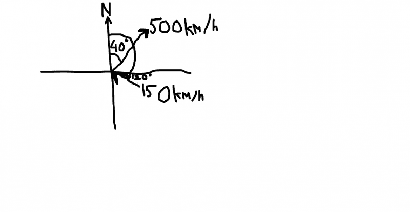

I guess I'll try to learn the components method as well then. Anyways, here's a sample problem (I already have solved it using method 2 and I got the right answer) that I'd like to solve using the components method:
Question: An airplane is flying at an airspeed of 500 km/h, on a heading of 040 degrees. A 150 km/h wind is blowing from a bearing of 120 degrees. Determine the ground velocity of the airplane and the direction of flight.
The diagram:
_____________________________________________________________________________________________________________________________________
I forgot to add the resultant but that would be just the missing side to form the triangle.
