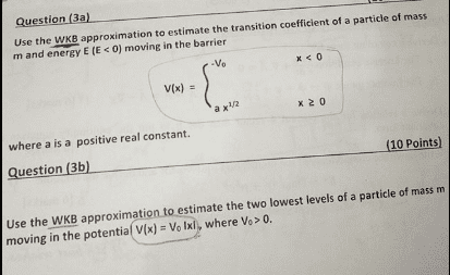

Hello every body i have two problems and i need a help from you
the problems are attached as a photo
these two problems about wkb method
1) at the first one i am confused some thing about the potential when x>0
what i did i studied the case when x<0 and take my turning points to be (negative infinity and 0) which also some thing confusing me but this is what i can do(if it wrong please correct it) now when the particle is going to positive x is it will feel a barrier potential even the potential is positive and energy is -ve if the answer is yes then i need a help to complete the solution
also i want a help for taking the turning point i think it when the energy equal the potential but i think this is not consist with what i see in most problems on tunneling
2) at second problem i divide it to two regions the at 1st region take turning point at (-x/v0 and 0)and 2nd case when x>0 i take turning point (0,x/vo) then make two integration is it correct or no ?

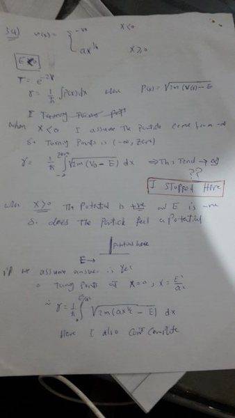

Ok .. really iam sorry .. should i edit the post ?
I'm not a mentor, so personally I'm fine. Point is I don't know where you are running into problems. Is the essence of the wkb method clear ? So what equation do you set up ?
this is what i did at first problem .. and i can't complete .. please also if you may help me how to determine turning points in such cases ..
  • Handwritten WKB derivation on lined paper: a piecewise potential V(x) equal to -V0 for x<0 and ax^4 for x>0, transmission T = e^(-2γ), and γ = (1/ħ) integral of sqrt(2m(V0 - E)) dx, with a boxed note 'I stopped here' and a sketch of a step potential with E marked.
I'm getting tired of opening the problem description, so:
Problem statement
Use the wkb approximation estimate the transition coefficient of a particle of mass m and energy E (E<0) moving in the barrier $$V(x) = -V_0\ \ (x < 0) \quad V(x) = ax^{1/2} \ \ (x \ge 0)$$where a is a positive real constant.
(That wasn't so hard! Much harder to decipher your handwritten solution attempt)​
Do I know what a transition coefficient is in this context ? Can I assume the exercise composer means transmission coefficient ? But there is no question of transmission, only some penetration...
## - V_0 < E < 0## with time independent SE solution ##e^{ikx} ##. Classical turning point is ##x = 0## Case ##a=0## can be done analytically. Been there, done that ?
Now what if ##a > 0## but still a small disturbance ? WKB ! Meaning: ...

sorry for bad handwriting (i made it so quickly )
yes you could assume that we want transmission coefficient
Ok if there a small penetration this may assumed to be transmission ,, we find transmission coefficient to determine the probability of such penetration
