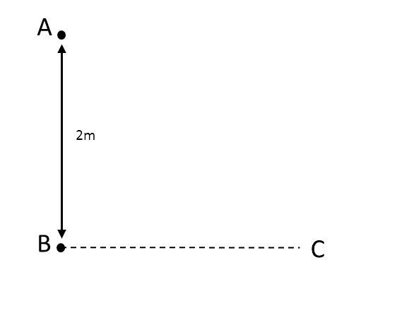

Two identical loudspeakers are located at points A & B, 2m apart. The loudspeakers are driven by the same amplifier (coherent and are in the same phase). A small detector is moved out from point B along a line perpendicular to the line connecting A & B. Taking speed of sound in air as 332 m/s, find the frequency below which there will be no position along the line BC at which destructive interference occurs.
I am not sure how would I approach this problem. I started with calculating the path difference when the detector is at a distance x from its initial position,
[tex]\Delta x=\sqrt{4+x^2}-x[/tex]
For destructive interference,
[tex]\sqrt{4+x^2}-x=\left(n+\frac{1}{2} \right)\lambda[/tex]
where ##\lambda## is the wavelength of the wave.
I don't know how should I proceed from here.
Any help is appreciated. Thanks!

Think:
What does lowest frequency mean for the wavelength?
How does the pathlength - difference change if the detector moves along x?
ehild

Lowest frequency means highest wavelength. For that should I substitute n=0? And then I will get ##\lambda## as a function of x. So should I find maximum of this function?

I tried that but had no luck. Substituting n=0,
[tex]\lambda=2(\sqrt{4+x^2}-x)[/tex]
Differentiating w..r.t x
[tex]\frac{d\lambda}{dx}=2(\frac{x}{\sqrt{4+x^2}}-1)=0[/tex]
This equation has no solution for x. :(
EDIT: Looks like the function has its maximum value at x=0. And this gives me the right answer. Thanks ehild! :smile:
There is no local maximum, but the function decreases with x, and x≥0. The function takes the maximum at the boundary.
ehild
