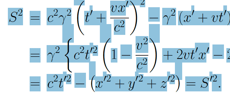

In Phillip Harris' (U. Sussex) post on special relativity he includes on p. 45 an algebraic proof of invariance of spacetime intervals. He starts with the definition S^2 =c^t^2 - x^2 -y^2 -z^2, he inserts the Lorentz transform expressions fot t and x, and he does some algebra to show that one gets the above expression back again. He skips a bunch of steps and I am going nuts trying to get his result. I attach a screen shot of the equations. I am ok with the first of them. Note, the y and z terms were cut off in his post, but they are pretty simple. Would someone kindly show me the algebraic steps.

If you cannot figure it out when you have the entire derivation, why do you think we can explain it to you with only pieces of it? Based on the fragment you posted, the only thing I can think of is that you might have missed that $$\gamma^2 \left(1-\frac{v^2}{c^2}\right)=1.$$

Thanks. The identity you wrote is an obvious one, but it does not help me understand the path to the last equation. If the full article would help you do so here is the url - https://web.stanford.edu/~oas/SI/SRGR/notes/srHarris.pdf
I am just a 76 year old legally blind guy trying to fill in some blanks in my understanding, and I was requesting assistance only with the algebra for the steps the author left out.
The first line to the second is just expanding the brackets from the first line and then collecting terms with ##x'^2## and ##t'^2##. The second to the third line just cancels as @kuruman says, and also cancels the two ##x't'## terms. That's it.

I understand. For future reference: If you see terms or symbols completely disappear in an equation, that means one one of two things: (a) in additions something was added to its negative giving zero; (b) in multiplications something was multiplied by its inverse giving a factor of 1 which is omitted in the product. Here you have both. Watch the step by step development
$$\gamma^2\left\{c^2{t'}^2 \left(1-\frac{v^2}{c^2}\right) +2vt'x'-2vt'x'-{x'}^2\left(1-\frac{v^2}{c^2}\right) \right\}$$First eliminate the two terms adding to give zero.
$$\gamma^2\left\{c^2{t'}^2 \left(1-\frac{v^2}{c^2}\right) +0-{x'}^2\left(1-\frac{v^2}{c^2}\right) \right\}$$Next remove the "0" that adds nothing and distribute ##\gamma^2##$$c^2{t'}^2 \left(1-\frac{v^2}{c^2}\right)\gamma^2 -{x'}^2\left(1-\frac{v^2}{c^2}\right)\gamma^2$$Next replace the product of ##\gamma^2## times its inverse with "1"$$c^2{t'}^2 \times 1- {x'}^2\times 1$$Finally remove the factor of 1 that doesn't change anything as a factor.$$c^2{t'}^2- {x'}^2.$$ As @Ibix said, "That's it."
I included all the gory details to show you the rationale behind these two algebraic transformations. Please be mindful that quite often you might encounter them going backwards, i.e. add and subtract a number or multiply and divide by the same number. These are useful when grouping terms into recognizable entities.
Thanks, Kurman, Ibix et. al. Once I gathered the t^2 and x^2 terms I got to the result. Instead of 3 steps it took me about 9 - guess that's why I am a chemist and not a physicist.
