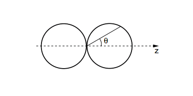

Given two spherical conductors of radius R and tangent at O, both are charged and in equilibrium with surface charge density ρs0cos2theta. Calculate:
a) Voltage of both spheres at O. (SOLUTION: V=2ρ0R/(3ε0)
So I tried to solve it, first saying that both have the same voltage on its surface, thus, the voltage at point O is the same as voltage anywhere else on the surface of any of those spheres. I integrated ρs on the surface on one sphere, (R between 0 and R, and theta between 0 and 2pi), and I got a charge of R2ρ0pi/4 on one sphere,
Then I use Gauss to find the Electric field made by such sphere and integrate to find the voltage on the surface of the sphere, and I got V=ρ0R/(8ε0). I cannot find what's wrong

The solution is not a formula, it is just what the textbook gives as a solution. I don't know why I was thinking of polar coordinates, so I have the wrong limits for the integral o0). I just saw the drawing. It was on the back of the page, so now it should make sense. But now that I saw the drawing, I can't calculate ds for the integral

OK, the diagram helps. With theta defined that way, I confirm that the formula for charge density is indeed a solution.
But it's easier to work in terms of angle subtended at the centre of the sphere. Let A be the point where the chord shown touches the sphere at top right. What angle does the chord OA subtend at the centre of the sphere? Call this angle ##\phi##. Consider the circular band width ##d\phi## passing through A. What potential does that produce at O?
