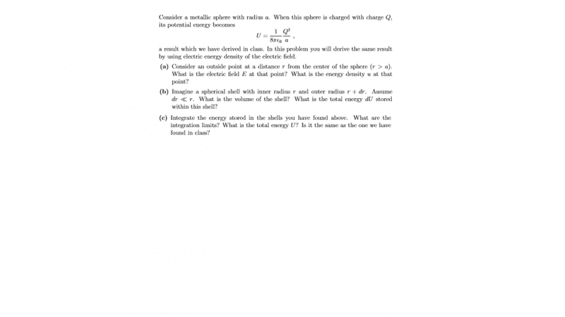

I fount these
Part(a)its ##E=\frac {ρa^3} {3ε_0}## and
##υ=\frac 1 2ε_0E^2##
Part (b)
##dU=4πr^2drυ##
Part (c)
##U=\int_0^a 4πr^2udr## but it gives me ##U=\frac {-Q^2} {8πε_0a}##
This"-" bothers me.
How is the charge Q distributed for a metallic sphere?
What is ##E## for points inside the sphere?
What is ##E## for points outside the sphere?
[EDIT: Note that your expression for ##E## does not have the correct dimensions for an electric field.]
This"-" bothers me.
The "-" sign should bother you. Your integrand is positive (including the dr). So, the integral must be positive. But are you sure you want to integrate from 0 to ##a##? If you can answer my questions above, it should help you see what you should use for the range of integration.
Just in surface
TSny said:
What is EEE for points inside the sphere?
E=0
TSny said:
What is EEE for points outside the sphere?
##E=\frac {ρa^3} {3ε_0r^2}## where ##r≥a## I know in the upside I forget ##r^2##
TSny said:
But are you sure you want to integrate from 0 to aaa?
What else it could be.. ?
Monci said:
The idea of the problem is that you bring the charge from infinity, since at infinity there is potential energy zero, while using a spherical distribution of charge. With this in mind, what should be the integration limits?
I thought about that but it still give me nothing...
I am thinking there should be minus cause I am thinking like bringing charges from ##r=0## to ##r=a## but I should bring charges ##r=∞## to ##r=a## but still there appears "-" sign also in ##r=∞## case what should I use the volume...? Or is it make sense ?
The result of integral will be ##U=Constant\int_∞^a\frac {1} {r^2}dr=constant\frac {-1} {r}## I can't get rid of "-".I think its cause of potential energy case.
Is it ##U=Constant\int_a^r\frac {1} {r^2}dr## where r goes to ∞ ?

So, all the charge Q is on the surface. So, there is no volume charge density ##\rho##.
E=0
Yes, ##E = 0## inside the sphere. So, what is the energy density inside the sphere? What would you get if you integrated the energy density over the volume of the inside of the sphere (##0<r<a##)?
There is no volume charge density. For points outside the sphere, try to express E in term of Q and r.
I'm not sure what you are doing here. Follow the outline given in the problem. How would you express the energy contained in a spherical shell of radius r and thickness dr?
TSny said:
Yes, E=0E=0E = 0 inside the sphere. So, what is the energy density inside the sphere? What would you get if you integrated the energy density over the volume of the inside of the sphere (0<r<a0<r<a0
Zero ?
##E=\frac {Q} {4πε_0r^2}##
##dU=4πr^2drυ##

Limits of integral
Arman777 said:
Limits of integral
You need to add up the energy in every spherical shell for which ##E \neq 0##.
from a to ∞ ?
a to ∞ ?
Arman777 said:
a to ∞ ?
Yes
TSny said:
Yes
İnteresting... ok thanks a lot
Yes, it is very interesting. The potential energy stored in the system can be thought of as stored in the field that extends from the surface of the sphere all the way out to infinity!
