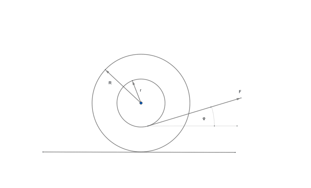

On the spool of the inner radius r and the outer R, a light unstretchable thread is wound, the end of which is drawn by the force F, as shown in the figure. The moment of inertia of the coil with respect to the horizontal axis passing through the center of mass is I. Determine the acceleration of the center of mass of the spool if it is known that the spool is rolling without sliding to the right and comment on the solution.
Second Newton law for translation and rotation
I solved this problem using second Newton law for translational motion and the same law for rotational motion, and got $$a= \frac {F} {m+ \frac {I} {R^{2}}} (cosϕ−rR)$$ where m is spool mass.
Now, we have three cases:
(a) ##cos\phi>\frac{r}{R}##, when spool is accelerating to the right,
(b) ##cos\phi<\frac{r}{R}##, when spool is accelerating to the left and
(c) ##cos\phi=\frac{r}{R}##, when ##a=0## and ##\alpha=0## (##\alpha## is rotational acceleration).
In the (c) case, if fraction force is ##F_f \le \mu N## (##\mu## is a friction coefficient), from ##mg=Fsin\phi+N## we get that for
$$F\le \frac{\mu}{cos\phi+\mu sin\phi}mg$$
spool is resting.
My question is: what is going on for ##F\gt \frac{\mu}{cos\phi+\mu sin\phi}mg##?

Your formula is valid for the "rolling without sliding"case. What happens if the horizontal component of the external force exceeds the maximum static friction? Is the assumption "rolling without sliding" valid then? Think of @haruspex 's hint about pulling a box on a rough floor.

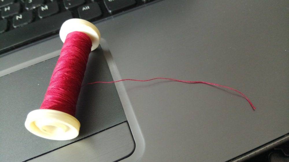

P.S. I even tried to do experiment with the object in the attached file. It mostly did the sliding but it seemed to me that it was because of its lightness and smooth surface it was on.

In any case, you have two equations, one for the translation and one for the rotation. Both equations contain the force of friction. You got one equation by eliminating the friction, and using the rolling condition: ##a=\alpha R ##. So you assumed that the motion was pure rolling which means that the contact point did not move with respect to the ground, the friction was static. But it is not true for big enough force.
If you apply such force, so as ##F\cos(\phi)>\mu N ##the spool will slide, and can also rotate, but the rotation and translation are not coupled. You have one equation for the linear acceleration and an other one for the angular acceleration, both containing the force of sliding friction ##\mu N##.
Remember that the coefficient of static friction is usually bigger than that for kinetic friction. In your very smart experiment, you have found an angle when the spool did not roll, and did not move at all. Increasing the force, you just overcame static friction, but that force was bigger than kinetic friction: so the spool started to accelerate, gaining some speed. But you - without noticing- decreased the force, so it just balanced friction so the spool maintained constant velocity.
