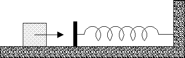

A moving 1.3 kg block collides with a horizontal spring whose spring constant is 491 N/m.
A) The block compresses the spring a maximum distance of 5.0 cm from its rest postion. The coefficient of kinetic friction between the block and the horizontal surface is 0.49. What is the work done by the spring in bringing the block to rest? REMEMBER: Work has a sign.
B) How much mechanical energy is being dissipated by the force of friction while the block is being brought to rest by the spring?
C) What is the speed of the block when it hits the spring?
W=F_0*d
I am unsure how to approach this problem. If someone could please walk me through it, that would help a lot! My teacher gave us this problem, but we haven't even learned this stuff yet. So please help me out!
Let's take question (A) first. So, when the block collides with the srping it has some kinetic energy, when the block stops it has no kinetic energy. Some of this kinetic energy will be used to do work against friction, what do you think the rest of this kinetic energy will be used for?
Is the rest of the kinetic energy used to hold the spring in place?

Not hold in place, but to compress the spring yes. So, do you know the expression for the potential energy stored in a compressed spring?

Close, that's the force required to compress a spring by xm; how about the energy stored?
PE=1/2kx^2?
bulldog23 said:
PE=1/2kx^2?
Sounds good to me. So, how much potential energy is stored after the block collides with the spring?

The value is correct, but what about the sign?
It should be negative because it is opposing the force of the block, right?

Yes, since the force extered by the spring is in the opposite direction to the direction in which the block is moving, the work is negative.

Wait, I see what's happened, we've used x = 5m, when actually x = 5cm = 0.05m
I can't believe I missed that.
So then the answer should be -.61375 J ? So then how do I do the same thing with friction for part B?

Do you know an expression for the friction force exerted by a surface on an object?

I'm afraid not, do any of these look familiar?
Is it F_k=U_k *N?
Oh never mind I got part B. Can you help me with part C though?
So you know that before the block collides with the spring it has some kinetic energy, after it's done work against the friction and the spring, it has no kinetic energy. So the total kinetic energy before the block collides with the spring would be...?
