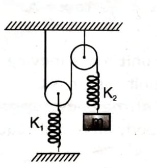

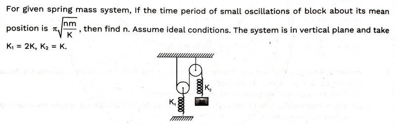

TL;DR Summary: I was solving this problem given in a book. The answer I got was wrong and seems to violate the conservation of mechanical energy. Yet the forces were balanced. Can someone provide an explanation.
So here is the problem:
In the above arrangement, I had to find the time period . For right spring, ##K_2=K## and left spring, ##K_1=2K##
In equilibrium,
$$T=K_2x=Kx=mg$$
$$2T=K_1y=2Ky=2mg \implies x=y$$(because of movable pulley)
Here is the problem.
For slow release of block (no change in KE), loss in PE of block is stored as PE of springs.
Because of movable pulley, thread moves by ##2y## and right spring extends ##x##. Therefore block moves down by ##(2y+x)=3x=3y##
By Conservation Of Energy,
$$mg(3x)=\frac{K_1y^2}{2}+\frac{K_2x^2}{2}$$
From my force balance equations above,
$$mg(3x)=\frac{2mgy}{2}+\frac{mgx}{2}=mgx+\frac{mgx}{2}$$(x=y)
This is not true and apparently violates the conservation of energy. So what happened to the rest of the energy if release was slow without change in kinetic energy.
What did I do wrong?
Ignoring the above violation I proceeded to as:
Since extension is both springs is equal, they can be treated as parallel combination of springs. ##K_{net}=K_1+K_2=3K##
Then time period is $$2\pi \sqrt{\frac{m}{3K}}=\pi \sqrt{\frac{nm}{K}}$$ then ##n=\frac{4}{3}## which is different from the correct answer:##n=12## Now this was rather expected as energy conservation was violated.
So how do I reach the correct answer?
Just a clear diagram of the question
