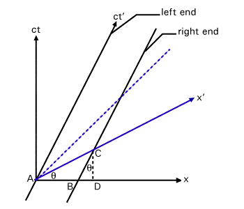

DaleSpam said:
Neglecting gravitational effects, you can define an inertial frame of reference which extends infinitely in all three directions in space and infinitely into the future and past. In that frame there is one "slice" labeled by t="now". That slice extends infinitely in all three directions in space but only for one instant in time.
You can also define a different inertial frame which is moving at a constant velocity wrt the first. This frame is equally valid, but will slice things differently. The "now" slice of that frame will also extend infinitely in all three directions in space.
So as long as you define your frame you can talk about the simultaneity of distant events.
Martin Gardner who is a physicist is describing something like this (although he gave another example). Supposed you can travel at the speed of light. From your frame of view, it would take you 0 second to reach the galaxy NGC 4203 that is 10.4 million light years away.. but for earth, millions of years have passed. Let's say the Earth got destroyed by china oversized nuclear arsenals 50 years after the traveller left. So from the frame of view of the traveller. He could say Earth got destroyed before he left (because his reaching NGC is simultaneous). For someone on earth. Earth got destroyed after he left. This is what Martin Garner meant the Now is not the same in the whole universe. But yet you said it can exist. Can you share the context of what you are saying with reference to this example about the traveller and NGC. How do you define an inertial frame that is common to the traveller traveling at lightspeed (or near the speed of light because I know nothing massive can move at the same of light) to the observer left on earth?
It has nothing to do with location, only relative velocity. Two inertial observers which are millions of lightyears apart but at rest wrt each other share the same rest frame. Two inertial observers passing near each other at .9c relative velocity do not share the same rest frame. The first two will always agree on simultaneity, despite the fact that they are far apart. The second two will generally disagree on simultaneity, despite the fact that they are close together.
