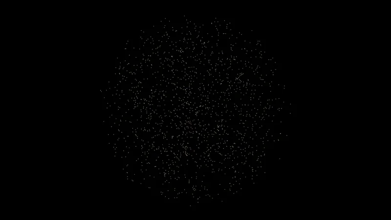

Such a map for all stars out to 100 ly is shown here:
This is an overlay of separate models. One for each spectral class of star, with each class given its correct Black body temperature color. This is useful if, for instance, you wanted to only show a particular class of star, which can be done by simple hiding the models for the other classes. If this particular file also had the visual magnitudes, you can create an attribute node for this, and then use it to control whether a star appears in the model, or possibly the visual appearance of the star( like the size representing visual magnitude).
The above image, being a still one, doesn't quite do the model justice, as the three dimensionality of it isn't apparent. For that, an animation is more appropriate.

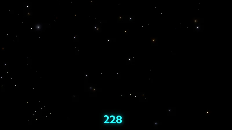

Since moving just a few light years would not make much of a difference, I decided to make this animation. It starts from 5 ly out and then recedes. I chose Ursa Major as the background constellation again, as it is one of the most recognizable. Since the original data didn't include the Sun, I added it as the small orange dot in the center of the image. It disappears when the animation reaches a distance beyond which it would no longer be visible by the unaided eye. It took a bit of fiddling to get things to look somewhat reasonable while still having stars vanish when they should as they dropped below visibility. Since the data I was working from didn't include the stars' absolute magnitudes, I had to work it out from their apparent magnitudes as seen from Earth, and then, from that, work out the apparent magnitude as seen from the receding camera.

Good job, man. You are getting places with your star map. Next step would be to color the stars according to the spectral class.

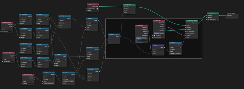

As per your request:
Getting the text to look proper for the second part took some finagling. The first part was pretty straight- forward. Basically it meant making an individual CSV file which only had a single row of information which related to the star I was labeling. Then using that file in the node set up and replacing the "star" with an instance of the text object for the label. Each label required its own geo-node set up. (praise be copy and paste!) For the second part, it was a bit different, As I had to make sure that the text instances rotated to keep facing the camera and since they would also be changing their distance from the camera, scale properly so their apparent size wouldn't change in the view. Here is the overall geo-node set up for a text object.
The red box at the top is the import of the CSV file. The red boxes on the left reference the right ascension, declination and parallax information. The collection of blue boxes to the right of them are the math nodes that convert these into separate x, y, and z coordinates.

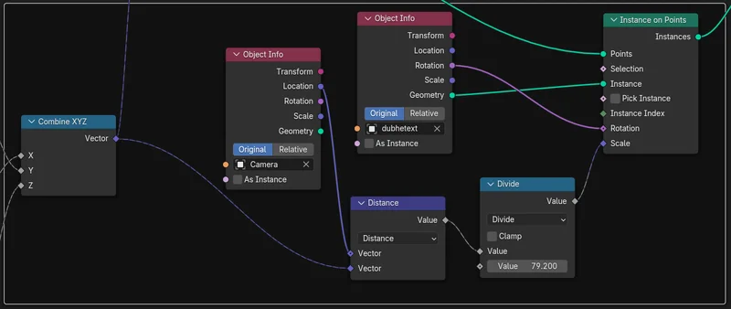

Here's a blowup of the black box:
The separate xyx coordinates are combined into a single vector output. You have two object info nodes, one for the camera and one for the text object. The location of the camera, along without the vector output we got earlier are fed into a vector math mode, which outputs the distance value between the text object instance and the camera. This in turn, is used to control the scale of the label we see, increasing or decreasing it as the distance increases or decreases, keeping the visual size constant in the camera view. The object info for the text object uses two outputs, the Geometry output to Instance input tells the set up that this is the reference object to be used to make the "label" instance. The rotation output tells the instance to keep the same rotation as the text object. If I now go outside of the geo-node set up and to the objects themselves (camera and text object), I can "parent" the text object to the camera. This way, the text object "follows" the camera, mimicking its motion and rotation, which, in turn assures that the label instance always keeps the correct orientation to the camera. If you're wondering why I didn't just feed the rotation info of the camera into the rotation of the Instance on Points node, that would have put the axi of both pointing in the same direction, meaning the camera would be looking at the "backside" of the label. The z axis of the text needed to point at the camera for the text to look correct.

You are speaking Greek to me, but I understand that this looks good. Dubhe is moving quickly compared to the other stars.

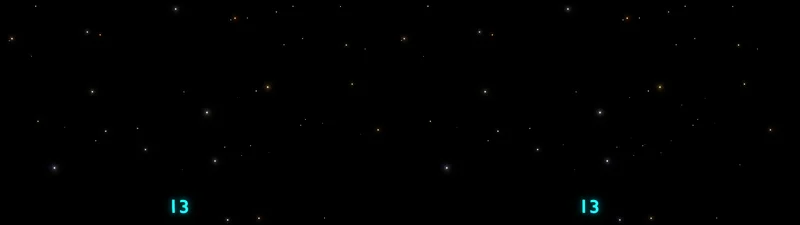

A new twist made possible by these maps being made as a 3d-model. Blender also has the ability to produce stereoscopic images in a number of different formats Red/cyan, side by side, etc.
So for instance this is a side by side stereoscopic image from one frame of a video.
You can view the effect by crossing your eyes until you see three images, with the center one being stereoscopic. It can take a bit of practice.
