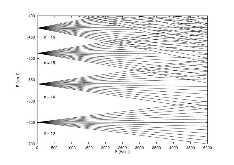

Stark effect (shifting and splitting spectral lines due to external electric field) is calculated in nearly all QM textbooks as application of perturbation theory (alongside Zeeman).
Wikipedia article ( https://en.wikipedia.org/wiki/Stark_effect ) has a nice figure with n-th level splitting into n-1 uniformly distributed sublevels:
It is hard to find published experimental results - please cite if you know some.
A clear one for Lyman series (2->1, 3->1, 4->1) can be found in historical "Der Starkeffect der Lymanserie" by Rudolf Frerichs, published January 1934 in Annalen der Physic (its editors back then: W. Gerlach, F. Pashen, M. Planck, R. Pohl, A. Sommerfeld and M. Wien), here are its results:
https://dl.dropboxusercontent.com/u/12405967/stark.png
These are clearly not uniformly distributed - how to understand/repair this discrepancy?
The top plot is of energy states. But the experimental lines are transitions between energy states. Some transitions are forbidden so you don't get every combination of energy states. Also, the results are polarized, so depending on the angle of view, some lines may not be visible.
It's easiest to solve the Stark effect in the parabolic nkm basis
The linear Stark effect levels are (atomic units, Z=1):
##E = -\frac{1}{2n^2} + \frac{3}{2} E n k##
At higher fields and higher n, you may have large deviations from linear.
And if you have a combination of Zeeman and Stark, they won't be equally spaced. See, e.g.
Breton et al, J Phys B: Atom. Molec. Phys 13 (1980) 1703-1718
We typically measure Hydrogen Stark Effect as part of the Motional Stark Effect diagnostic in magnetically confined fusion plasmas (looking at n=3->2 transition). In our case, the Stark effect dominates and the visible lines are approximately equally spaced.

Thank you Khashishi, but there still seems to be an inconsistency here, especially for Lyman-gamma (4 -> 1).
Could you maybe cite some paper which can explain these clearly not equally distributed sublevels for just electric field (Stark) ?
Or maybe some other experimental paper which includes Lyman-gamma?

I have decided to perform the calculations (https://dl.dropboxusercontent.com/u/12405967/lyman.pdf ) as described http://www.physicspages.com/2013/09/02/stark-effect-in-hydrogen-for-n-3/.
So we need matrix <n,l,m| z^hat|n,l',m'> for fixed n (assuming degeneracy) and all n^2 possibilities for l and m.
Possible shifts are given by eigenvalues of this matrix (times a*E*e)
For n=3 we get eigenvalules: {-9, -9/2, 0, 9/2, 9} - it fits to Frerichs' results assuming we don't see the 0 line.
For n=4 we get eigenvalues: {-18,-12,-6, 0, 6, 12, 18} - visually it seems to fit Frerichs' results assuming we don't see the {-6, +6} lines.
However, he got (10^8/lam): {102630.5, 102684.2, 102823.6, 102964.4, 103021.7},
after subtracting average value we get {-194.38, -140.68, -1.28, 139.52, 196.82}
The proportions suggest that the external lines should be ~140 * 1.5 = 210, so the observed ones are essentially narrower than predicted.
How to repair this discrepancy ?
Maybe someone has some more recent experimental results for Lyman-gamma (4->1)?
