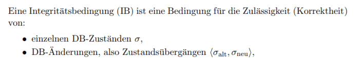

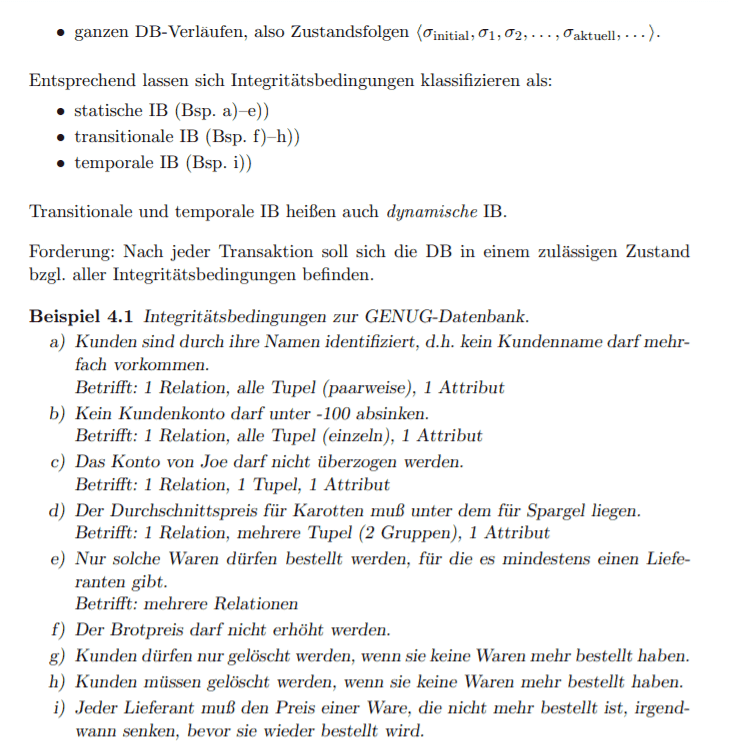

In my notes there is not a really definition... It is shown with examples :
Printed German text defining an integrity constraint (IB) as a condition on the validity (correctness) of single database states σ and of database changes, i.e. state transitions ⟨σalt, σneu⟩.
German lecture notes classifying integrity constraints: static (examples a–e), transitional (f–h) and temporal (i), with dynamic meaning transitional and temporal, followed by Example 4.1 listing constraints a) to i) for the GENUG database.
So from the definition you quoted a static constraint is something that is true in general and a dynamic constraint is something that holds at the specific case? :unsure:
As I understand it, a static constraint is independent of time, and a dynamic constraint is dependent on time.
Put otherwise, a static constraint is a constraint on the state of the database as is, and a dynamic constraint limits how the state of the database can change over time. 🤔
With this definition do we get the following ?
