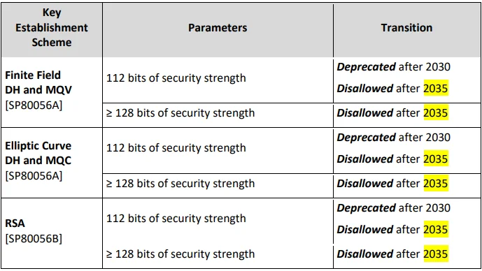

The US National Institute of Standards and Technology (NIST) issued an "Initial Public Draft" of crypto standards in November 2024 which included this table:
Table of NIST key establishment schemes with columns for scheme, parameters and transition dates; RSA, finite field DH and elliptic curve DH rows list 112 and 128+ bits of security strength, with deprecated and disallowed years highlighted.
Again, to decode: for RSA, "112 bits of security strength" refers to RSA-2048 - with a 2048-bit encryption key. You are likely using this method in many of you apps and settings today. What this table shows is that RSA-2048 should be deprecated (not used in new situations) after 2030 and no RSA method (for example RSA-4096) be used at all after 2035.
This is only a 18-month-old "public draft", but I have not found any more recent NIST interest in this topic.
