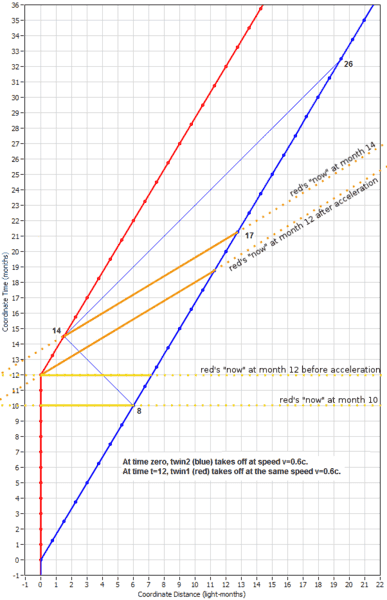

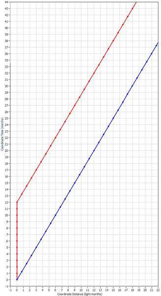

Hi,
I did a search for "crackpot physics" and found https://www.physicsforums.com/showthread.php?t=111647 and then this forum.
A friend of mine found some strange twins paradox on the net but he can't remember where.
Neither of us can figure out the solution, but it must be crackpot.
So, here is the strange twins paradox.
1) Assume T1 and T2 are in the same frame.
2) T2 instantly acquires some v.
3) Both remain in relative motion for some time t in the T1 frame.
4) After t elapses in the T1 frame, T1 also acquires the same v.
5) Both twins think each are time dilated. So, they conduct Einstein's clock synchronization method to compare their clocks.
6) After they compare, they have exact time values from the comparison. So, either t1<t2, t2 >t1 or t1=t2. Since these are actual time values, they are real numbers and must obey the law of trichotomy.
7) Yet, relativity says t2>t1 and t2<t1.
8) This violates the law of trichotomy of real numbers.
This must be wrong because relativity is always right.

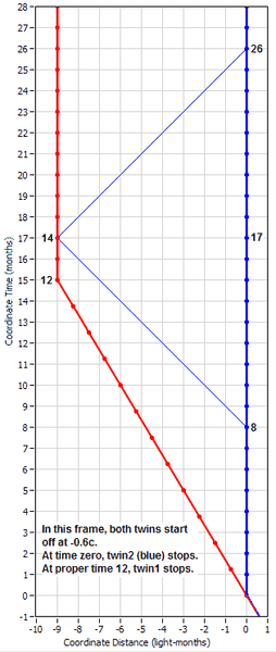

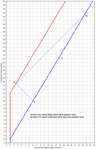

You've overlooked relativity of simultaneity in step 4. At the exact moment that T1 speeds up, using the T1 frame, what time appears on T2's clock? It is not the time that T2 says is when T1 sped up.
This paradox is most easily resolved by drawing a space-time diagram though; and it's been extensively discussed in another thread here... I'll see if I can find that thread later.

In steps 5 & 6 you said the twins' clocks ended up synchronized, which is wrong.

No, you are correct, each frame does see the other clocks as time dilated. So far this doesn't lead to the problem you mention in your OP.

JohnWisp said:
ghwellsjr said:
And if they are equal, the clocks are synchronized. So why did you deny that you said they were synchronized?
Why don't you show where I said the clocks were synched at the end of the experiment?
Oops, I goofed. Somehow my mind interpreted the phrase "they have exact time values" as meaning they were exactly the same. I apologize and to make peace, I offer you some diagrams to illustrate your scenario for the case where v=0.6c and t=12 months. First, a diagram showing the only frame you mentioned in your first post, that of the original rest state of the two twins:
The dots represent one-month intervals of Proper Time for each twin. Please note how both twins are time dilated after they both acquire a speed of 0.6c.
I have shown the synchronization process that twin 2 carries out at his Proper Time of 8 months. His signal travels over to twin 1 at his Proper Time of 14 months and he returns the signal. This return signal arrives at twin 2 at his Proper Time of 26 months. One-half of the round trip signal time is 9 months so he adds 9 months to 8 months and determines that twin 1's clock read 14 months when his own clock read 17 months. This is a difference of 3 months.
We can easily determine this difference if we realize in this scenario that gamma is the ratio of the Coordinate Time to the Proper Time for twin 1 at the moment he accelerates. Since the Coordinate Time is the same as the Proper Time for twin 2, we can say;
γ = CT/PT1
CT = PT2
γ = PT2/PT1
γ-1 = PT2/PT1 - PT1/PT1
γ-1 = (PT2-PT1)/PT1
Now we note that t = PT1 so:
t(γ-1) = PT2-PT1
Now I'm going to transform the above frame into one in which both twins are at rest after they both accelerate:
Now you can clearly see that the Proper Time of 17 months which is also the Coordinate Time is equal to the Proper Time of 14 months for twin 1.
