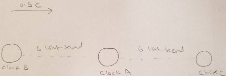

Hi,
There are three clocks - Clock A, Clock B, and Clock C. The distance, D, between each clock is 6 light-second. The clocks are situated in a frame of reference which is moving toward the right at speed of 0.5c where 'c' is taken to be 300000000 m/s. Please look here: https://imagizer.imageshack.com/img921/4197/EaNwTf.jpg
The clocks are to be synchronized according to Einstein-Poincare scheme of synchronization. Clock A is situated in the middle of other two clocks. Clock A sends pulses to both other clocks at 12:00:00
For Clock B, the time of round trip is:
from A to B:
(c+0.5c)t=6 light-second
1.5ct=6 light-second
t=4 seconds
from B to A:
t=12 seconds
Therefore, total round trip time is: 16 seconds. It is assumed that one way trip time taken by the pulse is 16/2=8 seconds.
For Clock C, the time of round trip is:
from A to C:
t=12 seconds
from C to A:
t=4 seconds
Total round trip time is 16 seconds and therefore one way trip time is 16/2=8 seconds.
If the clocks are synchronized then Clock B should have shown 12:00:00 plus 00:00:08, i.e. 12:00:08, on the arrival of pulse. Similarly, Clock C should have also shown 12:00:08 when it received the pulse if it was synchronized with Clock A.
Am I following the synchronization procedure correctly? Could you please help me with it?
Distance in what frame? You have already been told in several previous threads that, if you do not specify a frame, "distance" and "time" have no meaning.
Moving relative to what? Are the clocks all at rest relative to each other?
You have already been told in several previous threads that there is no such thing as "moving" in an absolute sense; you have to specify what motion and speed are relative to, otherwise those terms have no meaning.
12:00:00 according to what? According to Clock A? According to some frame? Which frame?
You really, really need to stop leaving out necessary information when you describe a scenario.
Relative to what frame?
You haven't even specified a well-defined scenario yet. See comments above. Until you do, your questions are not answerable.
The frame of reference is the one in which clocks are situated and are at rest with respect to each other.
Moving to the right at speed of 0.5c with respect to a stationary observer who is located in a different inertial frame of reference.
According to Clock A and according to the same frame of reference in which clocks are located.
Relative to the frame in which clocks are located.
I hope it's clear now. Thank you.
So you have three synchronized clocks at rest with respect to one another in a row at 6 light-second intervals. You ask about the round trip time between the first two. It is obviously 12 seconds.
Any motion of clocks or frame as judged by some other observer is utterly irrelevant.
Synchronization of the clocks is also irrelevant. You are measuring round trip times. Clock synchronization does not enter in.
Saying things are “situated in” a frame is sloppy and inaccurate language, and is a source of endless confusion. Everything is always “in” every possible frame, so saying that something is in a particular frame is pointless - it’s in every frame, so of course that thing is in some particular frame.
Let’s try restating your question without the slop.
We have three clocks that are at rest relative to one another, and using the frame in which they are at rest they are separated by 6 light-seconds. We will call this frame R (for Rest).
We synchronize the clocks using the Einstein clock synchronization protocol. The central clock A emits a flash of light in both directions when it reads 11:00:00. When the flash arrives at clocks B and C we set them both to 11:00:06 (because we know that the distance between them using frame R is 6 light-seconds). The clocks are now synchronized with respect to frame R; that is, using frame R’s definition of “at the same time”, all three clocks read the same thing at the same time.
OK, now we’ve completed the setup, so we can get on with your thought experiment.
When clock A reads 12:00:00 it sends another flash of light both directions. It’s easy to analyze this situation using frame R, and we see that the flash arrives at clocks B and C when they both read 12:00:06.
There is another frame, which we call frame M (for Moving). If we use this frame to describe the situation, the clocks are all moving at speed .5c and they are not synchronized; that is, using frame M’s definition of “at the same time”, the three clocks do not read the same thing at the same time. Furthermore the distance between the clocks is not 6 light-seconds. It is something less because of length contraction.
Nonetheless, you can use frame M to calculate what clocks B and C read when the flash reaches them. Do the calculation carefully, allowing for time dilation, length contraction, and that clocks B and C do not read 12:00:00 at the same time that A reads 12:00:00 and the flash is emitted... and you will find that clocks B and C each read 12:00:06 at the two different times that the flashes are received.
When you try this, I suggest that you use a speed of .6c instead of .5c and separate the clocks by 1 light-minute using frame R (so the clocks will read 12:01:00 when the flashes arrive) - the calculations come out a lot easier that way. If you do I’ll even tell you what clocks B and C read at the same time (using frame M’s definition of “at the same time”) that clock A reads 12:00:00. B reads 12:00:45 and C reads 11:59:15 .
(I did that calculation of the times on clock B and C in my head, so would be grateful if someone less prone than I to sloppy mental arithmetic would check them)
Then the clocks are at rest in this frame, not moving at 0.5c.
Ok, but then your calculations are mixing values from two different frames, which is wrong.
Ok, but then your travel times are wrong.
