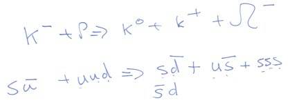

This one has confused me,
I know that Baryon number has to be conserved so X has to be a baryon.
I can see how charge is conserved
I know this is the strong interaction. Is it a collision?
Is that where the energy for the extra two quarks come from?
Is there some strange conservation rule at play.
I know I made them all blue quarks but I only had one pen
Thanks and sorry for two question in one evening

First, it has to be a baryon, to conserve baryon number.
Second, it has to be negatively charged to conserve charge.
Third, it has to have a strangeness of -3 to conserve strangeness (strong interaction, so strangeness is conserved)
So, to be a negatively charged baryon with a negative strangeness of 3, it must have quark structure sss
So particle X is an Ω-
I think the mistake made is saying that K0 is anti-down strange. That is the anti-K0
The K0 is down anti-strange
