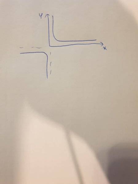

BvU said:
Make a sketch of the potential along the connecting line
I think I don't understand what do you mean. Do you mean an electric field sketch? Because the potential is a scalar and I don't know how to represent it graphically
can you make a sketch of the scalar potential 1/|x| ?
The function of the potential in terms of x is ##\phi=\frac {-k q_1} x +\frac {k q_2} {x+a}##
I can not draw the graph of this function, but the graph of the simple potential is something like this

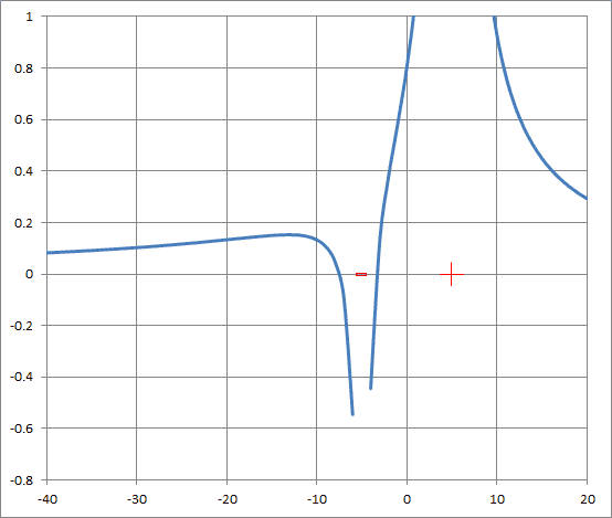

This is a sketch of 5 / |x-5| - 1 / |x+5|

Perhaps a bigger hint. Thinking in terms of forces:
When ##q## is far away, the force from ##q_2## dominates, so the force is repulsive. As ##q## gets closer, the distance squared term eventually balances the forces; and, after that, the attractive force from ##q_1## must dominate.

If you have any function in this case, you must look at ##x \rightarrow 0##, ##x \rightarrow \infty## and look for turning points.
It's doesn't matter how advanced the physics gets, basic calculus is always useful!

Thank you very much, now I understood. I just need to find the ##x## at which the forces generated by ##q_1## and ##q_2## on ##q## will be equal in magnitude, this is the boundary condition. And then I apply the conservation of energy and find out the velocity I am seeking for.
In other words: where the potential has a maximum
