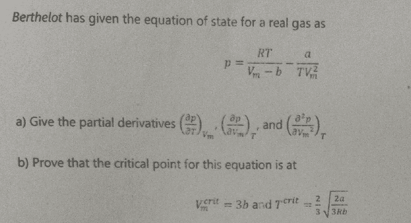

The task is the following:
I calculated the derivatives for Vm (crit) and set them = 0, but somehow I can't solve the equation to obtain Vm (crit) on one side alone.

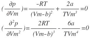

This is how far i managed to do it:
Can someone help me?
One approach: For each equation move the second term on the left to the right side. Then divide the two equations.
Wow, thanks!
I totally forgot that method
