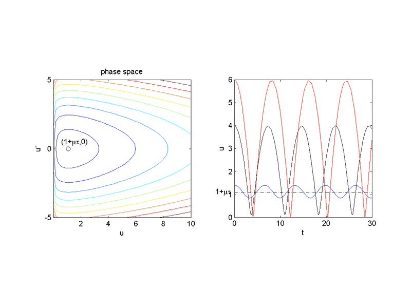

I'm sticking to the other one. [tex]u(\ddot{u}+1)=1+\mu\tau[/tex] has a first integral,
[tex]E=\frac{\dot{u}}{2}+u-(1+\mu\tau)log(u)[/tex]
It is then integrable, but no explicit expression for u is at hand. The phase space and solutions, however, are easy to draw (first figure). Pressure is well defined for small oscilations around the equilibrium, but not for large ones. Maybe that speaks about effects you neglected for the derivation
