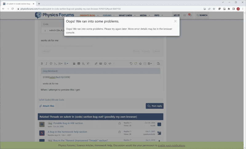

Can confirm. Putting the s back into the below causes the "Oops" dialog when I attempt to preview - Firefox on Android.
Code:
subtr($a,0,1)

When I attempt to preview this I get:
If I attempt to post without preview, I get the same until removing the s.
Same if attempting to Save after edit.
Same problem here. Firefox on Ubuntu.
It's actually the string substr() that creates the bug. With or without characters within the brackets; within BBcode or not.

It looks like I can preview a post containing the forbidden word once (in CODE tags or not), then get the error on anything I try to post (containing the string or not) on a subsequent try. Refreshing the page resets it. Did you try previewing more than once, @Greg Bernhardt?

I checked the console and it is a Cloudflare problem:
Code:
XHR POST https://www.physicsforums.com/threads/substr-in-code-section-bug-out-possibly-my-own-browser.1016515/reply-preview
[HTTP/2 403 Forbidden 45ms]
Followed by an HTML page (yes, in the console) that reads (error set at core-compiled.js:3:1515):
Please enable cookies.
Sorry, you have been blocked
You are unable to access physicsforums.com
Why have I been blocked?
This website is using a security service to protect itself from online attacks. The action you just performed triggered the security solution. There are several actions that could trigger this block including submitting a certain word or phrase, a SQL command or malformed data.
What can I do to resolve this?
You can email the site owner to let them know you were blocked. Please include what you were doing when this page came up and the Cloudflare Ray ID found at the bottom of this page.
Cloudflare Ray ID: 723865b31e5d713f • Your IP:
[my IP address redacted] • Performance & security by Cloudflare

I've made an adjustment to a CF rule. Can someone try again?
Code:
substr
Working for me! Thanks Greg.
