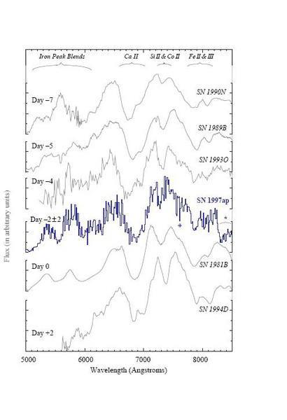

Hi, I have an image of a graphic describing the spectrum of a supernova Ia, the problem is that I don't really know how to read it. I'd like to know if there's any importance in this image that can drive us to think about dark energy (or accelerated expansion).
The explanation of the graph says:
Spectrum of SN 1997ap, after binning by 12.5 °A, placed within a time series of
spectra of “normal” SNe Ia 17,18,19,20,21 (the spectrum of SN 1993O was provided courtesy
of the Cal´an/Tololo Supernova Survey), as they would appear redshifted to z = 0.83. The
spectra show the evolution of spectral features between 7 restframe days before and 2 days
after restframe B-band maximum light. SN 1997ap matches best at 2 ± 2 days before
maximum light. The symbol
[tex]\oplus{}[/tex] indicates an atmospheric absorption line and * indicates a region affected by night sky line subtraction residuals. The redshift of z = 0.83 ± 0.005 was
determined from the supernova spectrum itself, since there are no host galaxy lines detected.
Thanks for all!
And here you have the image:

I'm a little confused as to whether you want to know the Astrophysics behind type Ia supernovae, or how observations of these showed that the universe was accelerating? If the former, I would say that is a topic in itself since, as marcus eludes to, the evolution of such objects is quite complex.
I would suggest, at least for now, that you restrict yourself to the acceleration of the universe (at least, if you want to get your project done in a couple of weeks) and not the Astrophysics of SNIa.
It's a judgment call, but I think Cristo is right and the best idea is keep it simple and go for the essentials. (BTW, SNe is short for "supernovae" the plural of supernova)
What we should try to do in this thread is review the essentials of how SNe data shows accelerated expansion. I'm going to forget that you have a course project, you do what you want about that (open another thread in another forum even). What we have to do here is to say in the simplest clearest way what's going on in those 1998 reports like Perlmutter et al.
A. Type Ia SNe are standard candles.
They all have approximately the same brightness, so measuring their apparent brightness tells you something called "luminosity distance."
Intuitively, dimness translates to a measure of distance. It's not the whole story, other factors play a role, but it's one possible measure.

OK, no one else happened to be around and put in a word, so here's what I suggest. This way you don't need any equations. You can produce a table using Ned Wright's calculator
http://www.astro.ucla.edu/~wright/CosmoCalc.html
If you put in a typical redshift like z = 0.5, and press the "general" button, it will tell you the luminosity distance in lightyears, actually in Gly (billions of lightyears).
Keep pressing "general" and put in different amounts of dark energy---change the 0.73 to what they thought it was back in 1998, which was zero. You will get something like 8 Gly.
That was what they expected.
Remember luminosity distance measures dimness. The dimmer it looks the farther it is, by that measure.
Well they were surprised to see that the luminosity distance was not 8 Gly, it was NINE Gly. More precisely it was 9.2 Gly.
"Hey, this supernova as a redshift of z = 0.5, so the DL is supposed to be 8 Gly, but it is dimmer than that, looks like a DL of 9.2 Gly!"
So let's put in a little dark energy. Instead of 0.0 put in 0.1
well a little better, the model predicts 8.387.
But what we observe is 9.2, so let's try adding more dark energy.
All we are doing is changing what is in the box where it usually says 0.73
This is the Omegavac box.
Keep z= 0.5 and keep changing Omegavac, and keep pressing "general"
Code:
0.3       8.6
0.4       8.7
0.5       8.9
0.6       9.0
0.73      9.2
They had to add an amount of dark energy to the model corresponding to 0.73 which means an amount 73 percent of the critical energy density (critical happens to be 0.85 nanojoules per cubic meter, but that doesn't matter.) The absolute amounts don't matter as much as that they had to add a certain definite amount to make the model predict the right luminosity distance (the right dimness) for the supernovas that they actually saw.
And they didn't only do this for a single redshift like z = 0.5. They had a whole bunch of data on supernovae of a bunch of different redshifts starting as low as z = 0.1, if I remember correctly.
I just took 0.5 as an example to work with the calculator.

pi.rootpi said:
...If SNe Ia are standard candles, they know the original bright, and they received the final bright, so, why did they try with more than one redshift?...
I think there are several reasons why they would want to use as large a sample of SNe observations as was practical and possible to get.
One is the normal errors you get in measuring anything. There is always some spread in the data. No matter how carefully you measure there will be random error in measuring the brightness, and even in measuring the redshift.
Another is that even though there is a reason for all type Ia SNe to be approximately the same brightness, it does not guarantee they will be exactly the same.
So it makes sense for the research team to measure many many SNe and average the results. Hoping that, although each individual measurement is wrong, averaging will make it come out right. The art of doing this properly is called Statistics.
Understanding how to do Statistics correctly is probably more important than knowing how to use a telescope, if you are an astronomer.:smile: But you should know both.
Did you read Wikipedia about Type Ia? I hope so. For me probably the most interesting question in this discussion is WHY the Type Ia SNe are all approximately the same brightness.
A binary star. One big and the other small:
A white dwarf that has finished fusion and is in some sense a
dead cinder----made mostly of Carbon, Oxygen and elements of about that weight.
It is not massive enough to have the pressure needed to fuse Carbon etc., so it is dead.
A red giant near the end of its life. It has swollen up and is slowly blowing off its outer layers.
Look! the outer layer of hot gas that the big partner is slowly losing, some of that is falling by gravity onto the little partner and building up the mass of the dwarf.
At some point it will have enough mass to create the internal pressure needed to fuse all that Carbon etc etc which it was unable to fuse earlier. This will happen at a particular mass threshhold. What will happen when that threshold mass is reached?
This is probably an oversimplification of the story. But I hope you have read some about the supernovae mechanisms. There are several different mechanisms causing stars to blow up. You should at least have some idea of how the Ia mechanism works and why it involves the explosion of dwarf stars which are all of about the same mass, and therefore it makes explosions which are all of approximately the same energy.
Hey! Yess, I have read and understood what happens before a Ia Supernova. (all of the degeneration effect created by the electrons -although i don't really understand why do they do it, I've read something about Pauli exclusion principle- and then when the red giant has "send" to the white dwar enough mass (1.44 the mass of the Sun) the carbon reacts due to the temperature and the start explodes (I hope everything I've said it's correct, I've written it more or less like this in my project.
Then my question is (BTW, thanks for your patience and help with me!) what makes the SNe spectrum so special? I mean, I've seen the light curve with the Ni and Co but I don't really get why the fact that the highest point of the luminosity graph is the point when it also will decrease faster, makes them so important.
Thanks and Happy Christmas!
pi.rootpi said:
... what makes the SNe spectrum so special? I mean, I've seen the light curve with the Ni and Co but I don't really get why the fact that the highest point of the luminosity graph is the point when it also will decrease faster, makes them so important.
It is fun talking with you, PiRootPi. You read and think and learn stuff on your own.
You should also connect with Cristo and George Jones and others. If necessary write them PM (not about your school project because our policy is not to help, but about general questions).
A fast-learning person should not rely on just one resource-person.
BTW I am not an expert about Ia SNe but I have the impression that what we see is not the explosion but the radioactive decay of radioactive isotopes after the explosion.
The explosion itself would be a tiny source of Xray. We normally do not see the Xray or gammaray light.
If stuff is too hot it makes a small percentage visible light, it makes a larger percentage of Xray light. The flash of the actual explosion is finished very soon. Most of the energy is not in visible wavelengths. It is small (about the size of a star)
Afterwards there is a big cloud. Hot, from radioactivity. This is what makes the visible light. One reason it has high luminosity is because it is very big, millions of times bigger than the original star and the original explosion.
I could be wrong, or this might be an oversimplification. You should get some other people's ideas. Have to go out to do Holiday errands.
