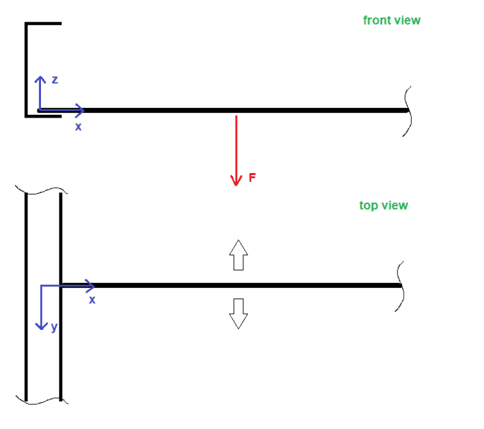

I am a mechanical engineering hobbyist. By now I'm designing some small production line in which I'm gonna include a robotic station. In general, heavy robotic arm is gonna be suspended on a beam that moves in one direction along the rails.
I'd like to calculate the whole structure including welded beams and then calculate rails and the beam used for suspend a robotic arm. The problem is I've no idea how could I start.

Yeah, I know this stuff (statics, kinematics, dynamics, materials) a bit. I mean I can calculate simple cases like bending beam or beam in tension, compression or shear. The problem is sometimes I dunno how to apply this knowledge to realistic projects. Let's say I'd like to calculate one of my rail which is a C-profile like on the following figure
the beam can move along the C-profile, F=1500N. So I guess for C-profile I should calculate:
- bending stresses for bottom wall of the C-profile (the torsion/bending moment around the Y axis), and this is simple because this is gonna be const regardless of actual location of the beam
- weld strength (C-profile is fixed by welding on its ends) - and this also seems to be quite simple but specific result will depend on actual beam location, so I don't know which location choose to calculate max stresses (maybe center location?)
- bending stresses for entire C-profile (the torsion/bending moment around the X axis), but again, specific result will depend on actual beam location .
All of the calculations in this project I make to determine max stresses and based on that choose the correct C-profile type (in this project I assume that I don't have any C-profile to use and need to choose and buy the correct one)
So Is it right for this case?
A floppy structure, with minimum cost and weight, can be rigid in the dimensions that are critical. For the rail, consider:
1. A closed section rail (torque tube) to prevent axial twist;
2. Having the bridge beam run on the rail at the centre of rail twist, so any twist of the rail does not result in a change in the x or z of the bridge beam end, and vice versa, reduces twist;
3. Having the bridge beam ends, constrain the rail rotation by running on two edges or corners, not on one flat;
4. More than one of the above, but keep one degree of freedom flexible, so accuracy of construction is not over-constrained.
