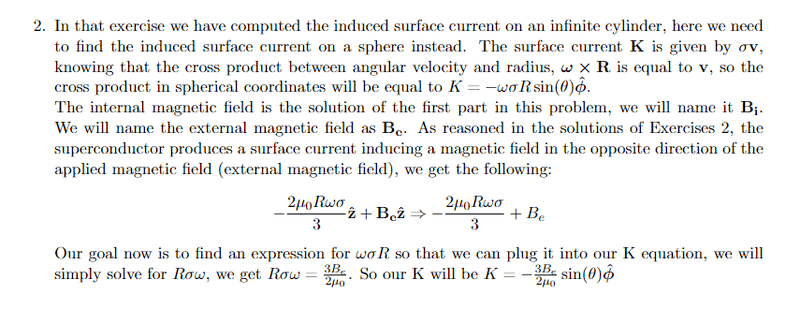

Find the surface current on a spherical superconductor.
K=sigma * v
I need help with part b.
Typed homework problem 2 with two parts: part a gives a piecewise vector potential A(r,θ,φ) for a spinning charged spherical shell, inside r ≤ R and outside r ≥ R; part b asks about the surface current on a superconducting sphere in a uniform magnetic field B.
My solution:
Typeset text of exercise 2 on a superconducting sphere: surface current K = sigma v, cross product in spherical coordinates K = -omega R sin(theta) phi-hat, then B_i and B_e relations leading to R omega = 3B_e/(2 mu_0) and K = -(3B_e/(2 mu_0)) sin(theta) phi-hat.
Have I done it right?
Your work looks right to me.
