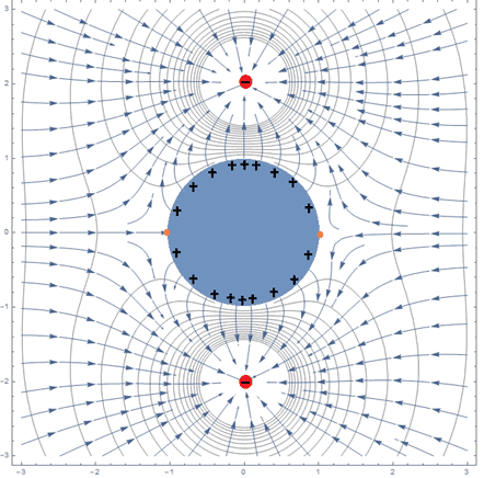

If your argument is valid, then it seems to me that it should apply to any conductor in electrostatic equilibrium.
But it is not hard to come up with an example where you have a conductor with non-negative charge density at every point of the surface of the conductor and such that some points of the surface have zero charge density.
Here is an example. It consists of a large conducting sphere (blue) with a net positive charge Q and two very small conducting spheres (red) which each have a net negative charge -q. The large sphere is symmetrically placed between the two small spheres. The figure shows the direction of the field lines and also shows some equipotential lines.
Field-line plot with equipotential curves: a filled blue circle at the origin with small black plus signs on its upper and lower surfaces, two red circles with minus signs at (0, 2) and (0, -2), and two orange dots on the horizontal axis at the circle's left and right edges.
It is possible to choose the the ratio q/Q such that the charge density is positive at all points of the surface of the large sphere except for the "equator" where the charge density is zero. The two orange dots are points on the equator (the charge density is zero there). Although the field is zero at the equator, the field becomes nonzero as soon as you move perpendicularly off the surface at the equator. For all points in the plane of the equator that are outside the larger sphere, the field points directly toward the center of the large sphere. But as you get closer to the sphere in the equatorial plane, the field gets weaker and goes to zero at the equator.
So, the large sphere is a conductor with non-negative charge density everywhere on its surface and also has points on its surface where the charge density is zero. It seems to me that your argument doesn't work here.
However, for this example, the net charge of the total system is negative. So, it does not correspond to the statement of the original problem! So, we still have an open question as to whether or not the statement of the problem is correct. That is, if the net charge of a system of conductors is positive then is it really true that there must be a conductor in the system with surface charge density that is strictly positive (never zero at any point of the surface)? I don't know.
Is the positive conductor in this situation part of the space with the highest potential? If it is then my argument doesn't work.
However, if the positive sphere is not on the highest potential then I think my argument is valid.
In my example, the positive conductor is not the place of highest potential. The highest potential is zero (at infinity).
Let's get back to situation with net positive charge in space. Part of my argument was that if the surface density was 0 at some point then space close to it should be on same potential.
I don't feel comfortable with this part of your argument. If σ = 0 is zero at a point of the conductor, then E = 0 at that point. But I don't see why E must be zero for other points in the neighborhood of this point and exterior to the surface. So, I don't see why it's necessary that the potential be constant in this neighborhood. But I do think you have a key point that the conductor of interest is the region at highest potential. Maybe your argument is fine and I'm just being dense. I just wish it could be "tightened up".
