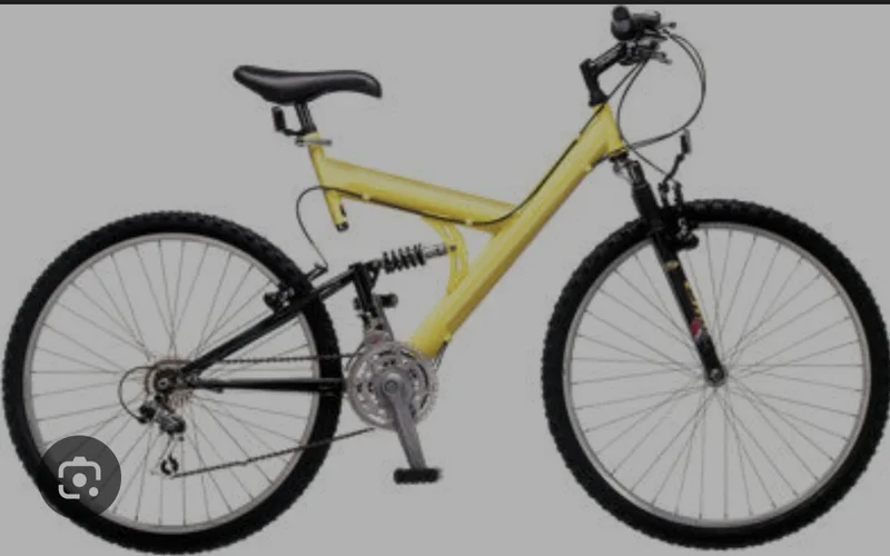

What is the difference if the wheel is 12" vs 14"? Does 14" wheel have suspension characteristic similar to the 12" with suspension?
Also see the image below. The suspension is put differently. What would happen if the 12" balance bike in original message has this suspension configuration?
Or what would happen if the following big adult bike has suspension placement similar to the original message 12" balance bike suspension (see original image)?
No difference. The hinge pin is still on the crank axis, so the spring still controls the height of the seat above the ground.

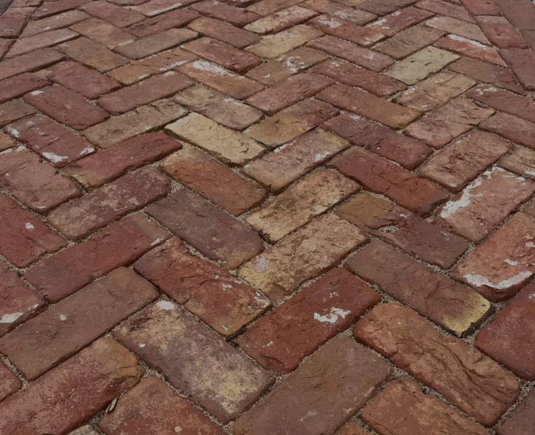

The reason I was looking for suspension for the 12" balance bike was because our enclosed or fenced apartment outdoor flooring uses Clay Brick Pavers like the following:
Close-up of a herringbone pattern patio made of weathered red and tan clay brick pavers with mortar joints and some white efflorescence stains.
There is no other place to use the 12" balance bike. We can't use it inside house as the area is small. And we can't use it in the public road, obviously to avoid hazard from cars or other vehicles. Do you call the above bumps high frequency or low frequency bumps? How would bigger tire help and suspension? If I get 14" balance bike without suspension, how would it behave compared to the 12" balance bike with the suspension (as in the image in original message)?

If it will only be used in the yard then it does not matter what you get. The pavers are mostly level, so lower the tire pressure slightly if needed to hide any uneven joints. Use the smallest wheels available since that will aid turning in the confined space.

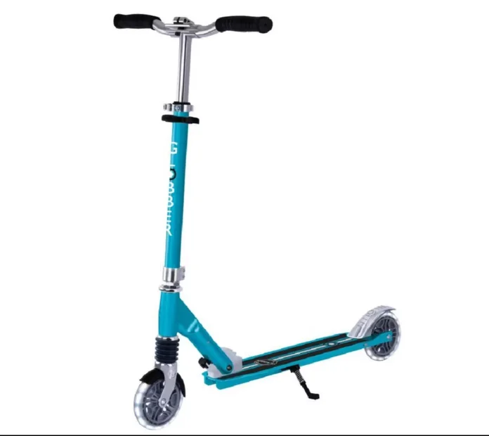

I used the following scooter with 5 inches wheel and suspension on the pavers weeks ago and I could feel the bumpiness. So you are saying the bigger wheel of the bike can average more of the surface and hence the bumpiness will be entirely gone? If not entirely gone, the suspension of the bike can help, why won't it?

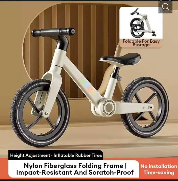

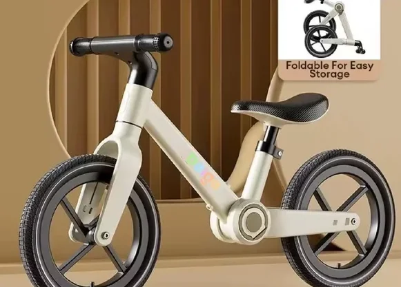

I ordered the following before and received it but the bearing was knocked out of 12" wheel during shipping and I was waiting for replacement of the wheel. I can sell it after assembled and get the one with suspension pending some computations and mechanical analysis..
Cream-colored children's balance bike with black handlebar grips, a padded black seat, and two black rubber tires on spoked wheels, with an inset photo of the bike folded. Overlay text reads Nylon Fiberglass Folding Frame | Impact-Resistant And Scratch-Proof.

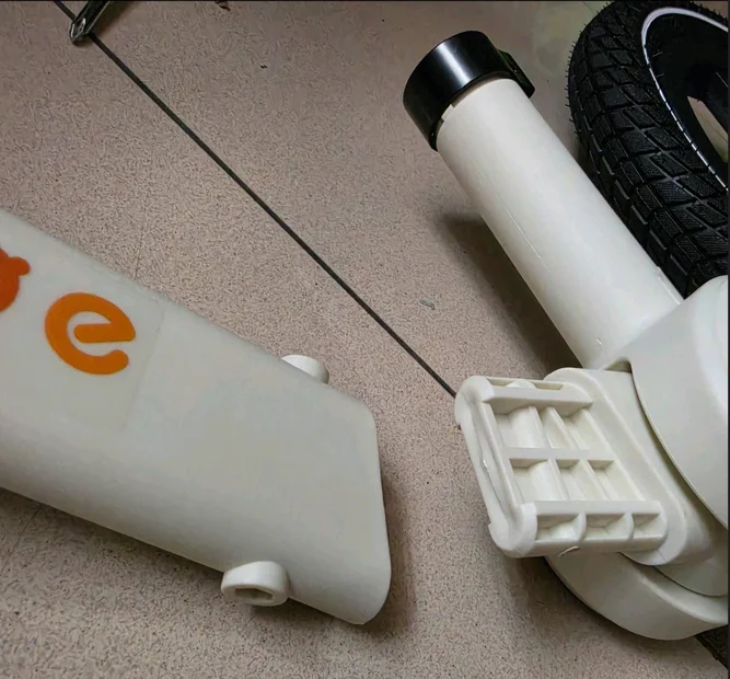

It says in the manual it can support 30 kg. In the middle there is a joint connecting the front to the bending mechanism.
Photo of a white plastic front fork and wheel assembly of a balance bike on a beige carpet, with an orange letter e on the left fork section and a black tire with tread at upper right.
I'd like to ask about Nylon Fiberglass. There is glass inside the nylon and it is very strong in tension. So can the joint at right side able to support 30 kg. or is it 15 kg as it is at center? And can 12" pneumatic wheel support 30 kg? How do you compute what is the maximum weight that can be support by a 12" pneumatic tire?
That scooter has solid rubber tires, so no wonder you felt the bumps! You need pneumatic tires to get that part of the suspension system of a bicycle. What kind of wheels does this new balance bike have? Pneumatic or solid rubber?
Cream-colored balance bike with two large black-rimmed wheels, a padded black saddle and handlebar grips, with a small inset photo showing the bike folded, captioned Foldable For Easy Storage.
BTW, depending on the diameter of the downtube on that seatpost and your kid's inseam, you may be able to get a standard seatpost with suspension built in that will work. That will cushion the ride for the little one. Measure the seatpost downtube diameter and look at suspension seatposts like these:

The only bumps you felt were when the small hard wheels of the scooter fell into the gap, or crossed the step difference at the gap between pavers. The bigger wheel with lower tire pressure will completely hide that step change from the rider. If the step change was sufficient to cause a rough ride, then you would trip when walking on the pavers, and so you would reseat them, eliminating the problem.

Spring suspension reduces the shock on the bike frame, and increases the comfort of the rider when off-roading. Spring suspension will only be an advantage when crossing gutters or curbs that might suddenly lift or drop the mass of the rider by more than about 50mm, 2".
Suspension will not help in your yard because the height of the pavers are all about the same. There are no sudden changes in the height of the rider above that level, so the averaging effect of two pneumatic tires will more than suffice to bridge the gaps between pavers.
