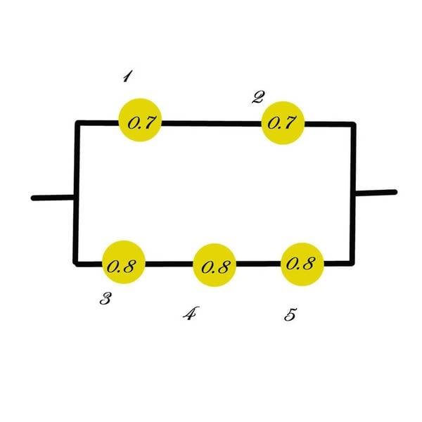

The numbers represent the probability that each component works.
a) What's the probability that the entire system works?
b) Given that the system works, what's the probability that the component A is not working?
a) P=.75112, easy
b) Don't know what to do here...
Since there is no component A in the diagram, I'd say you can't answer the second question.
If you were asking this: Given the system works, what is the probability [tex]1[/tex]
is not working, think this way:
If the system is operating, you know that
* [tex]3, 4[/tex] and [tex]5[/tex] are all operating
and
* [tex]1[/tex] is not operating, status of [tex]2[/tex] is unimportant
what can you do with this?
