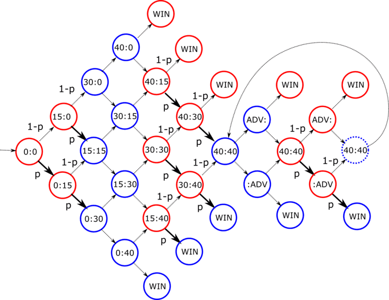

Let the player, who serve first, be "Red" and his opponent "Blue".
The graph of the game is:
The color of a circle indicate who serve and in a circe is the current score.
The probabilities (p and 1-p) are written next to the arrows.
Does the probability to win on the opponent serve is the same for both players ?
But the same player serves every time within the same game. You seem to believe that the players alternate to serve in a game. It isn't so, except in a tiebreak game.

In my opinion two parameters are needed:
p - the probability that the first (red) player wins on his serve
q - for the other player (blue) to win on his serve
Of course:
1-p and 1-q are the corresponding "loss" probabilities
Here (tennis.svg) is a graph drawn in Inkscape (SVG format) if someone wants to use it so as not to draw everything from the beginning.

Just in case you were still unsure here is how the game progresses. The player P1 below is serving though-out the game.
