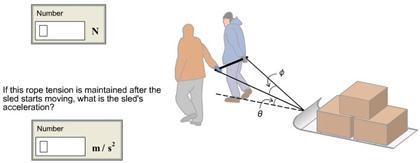

A heavy sled is being pulled by two people as shown in the figure. The coefficient of static friction between the sled and the ground is μs = 0.579, and the kinetic friction coefficient is μk = 0.435. The combined mass of the sled and its load is m = 336 kg. The ropes are separated by an angle φ = 25°, and they make an angle θ = 30.1° with the horizontal. Assuming both ropes pull equally hard, what is the minimum rope tension required to get the sled moving?

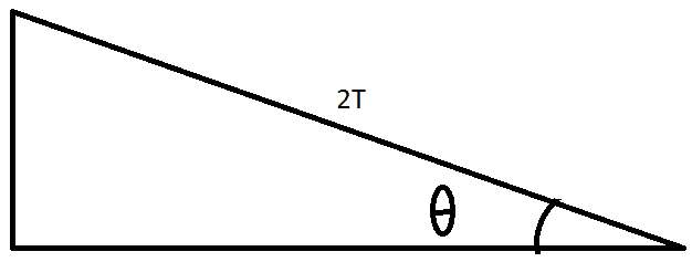

T-mg=ma (I think...)
So, say person 1 exerts tension T1 and person 2 T2, so T1=T2=T ...So they both exert a force of 2T.
I am not even sure if this diagram is right?
I also think wemust must find Ff,s = μs * Fg
I don't know where to go from here or I if this is where I should even be

I think you'll want to start by seeing what single force applied at angle θ = 30.1° will get the sled moving. After that you can deal with how to divide that force between two ropes with the given angular spread.

If I am going to divide an angle wouldn't it be φ = 25°?

Dealing with φ will come later. Treat this as two separate problems: 1) Find the force required to move the sled if the force is applied to the sled at angle θ; 2) Take the force from (1) and split it between two ropes separated by angle φ.
