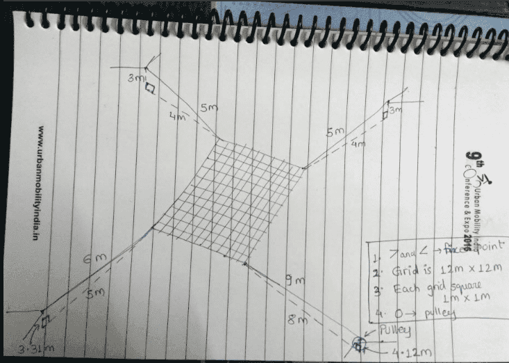

A grid made of ropes is suspended by its four corners with strings tied to four different points on a building. Three of which are fixed and fourth is attached to a pulley which is in turn fixed to the building.
Given data :
Grid mass is 25 kilogram suspended at a height of 6m
Gravity is 9.8 m/s^2
Length of strings used to suspend grid are 5m, 5m, 6m and 9m(tied to pulley).
X and Y components of strings are given.
https://imgur.com/a/7MHwl (Diagram)
Handwritten sketch in a spiral notebook of a rope grid suspended by four strings from fixed points, with a pulley at the lower right; labels include 5m, 4m, 3m, 6m, 9m, 8m, 3.31m and 4.12m, and a notes box lists grid size 12m x 12m and 1m x 1m squares.
Calculate tension in each string.
I know how to find tension in two strings which suspend an object at a common point. How can I calculate
tension which object is suspended at different points?
I am not from physics background and am a software developer. I understood basic tension calculations but couldn't work out for four strings suspending object at different points.
P.S. -> I am new to physicsforums. I read the rules and checked existing posts but couldn't find a post I could understand and borrow from for my given problem.
This is for an art installation. I need to calculate tension in strings as I have to order motors with appropriate stall torque for pulley winding/ unwinding. If I have created this post in the wrong section please let me know and I will move it to the appropriate section.

Your question is not clear,
You can establish equilibrium condition in x-y-z directions,
There is not enough information. You need the x,y coordinates of the suspension points relative to the grid.
You will also need to make some assumption about the grid behaviour. I assume it is held fairly taut, so can be treated as a uniform flat plate.

I think its not going to be as taut to be treated as a uniform flat plate unfortunately. This is how the original installation looked like. Though it won't be as loose as shown in image. https://static.wixstatic.com/media/.../a18de6_aa9c4fbd418b47d0a71a81dbf69e4bc1.webp
x, y co-ordinates of suspension points relative to grid? What do I consider the origin in this?

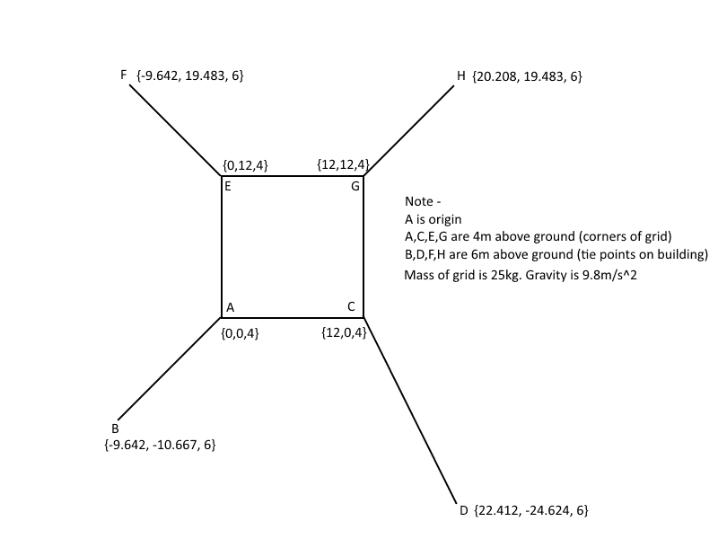

Hi. I have upgraded the diagram according to your guidance.
Link to diagram : https://imgur.com/a/LflI1
All points are measured with respect to origin at point A.(bottom left corner of grid)
Mass of grid is 25kg.
Gravity is 9.8m/s^2.
I tried to calculate Tension using matrix and solving equations simultaneously as following.
Link to calculations : https://imgur.com/a/yz4cQ
But couldn't solve it for any string as there are always at least two non zero entries in each row.
Are my co-ordinate positions correct relative to the grid? Am I solving it the right way?
I solved similar problems of particle equilibrium and was able to solve them. Though, in all those examples there was a common point at which the load was suspended. In my case load is suspended at different 4 corners. Correct me wherever wrong.

There are many different solutions to this problem . How the loads distribute between the cables depends on how they are adjusted for length during installation .
If the cables are installed without careful adjustment then one of the four is always likely to be slack . You can use this fact to advantage by assuming that each of the cables in turn is slack and solving for tensions in the other three . Find worst case .
  • Diagram of a square grid with corners A, C, E and G at height 4m, connected by cables to tie points B, D, F and H at height 6m, with listed coordinates for each point.

Hi. For now let's assume that square is rigid. I want to know, what I did in calculations, is it right? Or are there any other ways to do this?

Hi Nidium. Thanks for simplifying what others have stated. I have made approximations in suspension cable lengths and calculated for both cases.
1. Actual (where the dimensions of cable are roughly similar to the actual dimensions)
2. Approx (where I have considered all the cables to be in symmetry and of equal length.)
Here is the link to diagrams.
https://imgur.com/a/QF16i
Here is the link to calculations.
https://imgur.com/a/LLQbN
Are they correct? For actual part worst case torque is around 1.8Nm and for approx part its around 1.2Nm.
The motor I have been looking at provides 4.9Nm. So Factor of Safety for actual is around 2.5 and for approx is 4.0.
Please correct me wherever I am wrong.
