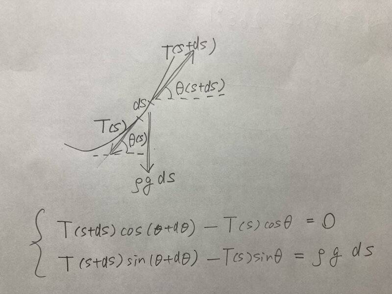

If the rope has density ##\rho## then a section of it length ##ds## has weight ##\rho g\cdot ds##.
But to solve the question you do not need to consider small elements like that. You can treat the halves of the rope as the two rigid bodies.
Adding to the above: The infinitesimal FBD only needs to be considered if you need to know the shape of the rope. It will lead to a differential equation for the rope’s shape that is significantly harder to solve* than the algebra required to solve this problem.
* The solutions being catenary curves.

But what's the problem in choosing small elements?
Balance of forces in horizontal and perpendicular directions.
Handwritten free-body diagram of a small rope element ds with tensions T(s) and T(s+ds) at angles θ(s) and θ(s+ds) to the horizontal, weight ρg ds acting downward, and two force balance equations below.
There is no problem per se. It just leads you to a differential equation that you will need to solve. It is completely unnecessary to solve the problem at hand. It is not wrong, just not very useful.

The tension is higher at the endpoints than it is at the middle of the rope.
One can see this almost immediately if one contemplates a horizontal force balance. The horizontal component of the tension force must be constant across the entire span. Else a segment somewhere would be under an unbalanced horizontal net force.
Since the angle of the dangle changes from one segment to another, the local tension must also change in inverse proportion to the cosine (or sine depending on how you measure) of the angle. That way the horizontal component can remain constant.
Indeed, and it is the difference in the angle on opposite sides of any segment of rope that provides the vertical force required to keep it from falling.
