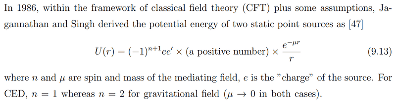

I still haven't read the original article by Jagannathan and Singh, but for completeness I want to display their result, as quoted in this more recent paper https://arxiv.org/pdf/1310.3539:
(Here ##ee^{\prime}>0## for like charges and ##ee^{\prime}<0## for opposite charges.)
