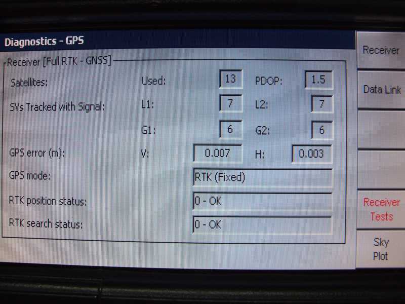

Yup, it really is that accurate ! ... I service Trimble GPS equip for machine control and surveying
here's a screenshot off a bit of gear I worked on ...
NOTE the 7mm vertical and 3 mm horizontal accuracy. Horizontal acc. is always around 2 times better than vertical
Also note that the GPS accuracy of your avg public in car or tramping handheld GPS unit is around 10 - 10 metres in comparison !
So various organisations eg USGS (US Geological Survey) have a wide network of GPS receivers that they collect data from continuously
Tiny variations in equip inaccuracy can be averaged out over time and the true motion of the land can easily be observed.
They can measure how much the land is compressing up ( or maybe stretching out) over a period of time and from that work out strain rates across a region.Dave

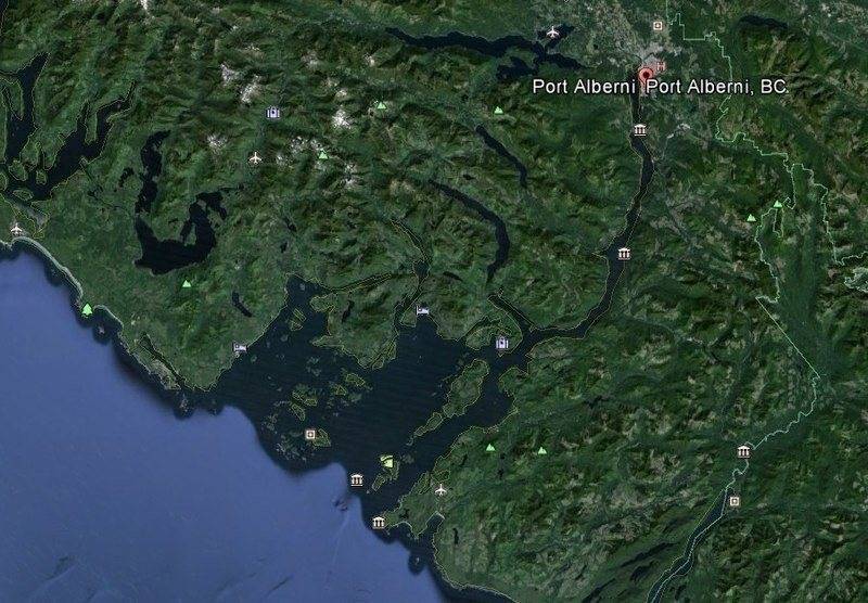

I'll never forget that day in 1964. I lived in Port Alberni, BC, a small town app. 50 miles inland at the end of a fjord on Vancouver Island. When the wave hit us, it was still about 3 metres or so in height. It did a great deal of damage. A graveyard shift was at work already at the sawmill and plywood mill and pulp mill. Workers on the ground floor stated they saw a floor to ceiling wall of water come at them. They all floated momentarily and were then deposited back on the floor. NO ONE was killed and only a few were hurt. Several homes along the inlet at sea level were floated away. Again, no one killed or injured badly. What was really weird was that the inlet on which Port Alberni is situated is at a 90 degree angle to the direction the wave would have had to traverse. In other words, when the wave reached the west coast of Vancouver Island it took a hard left turn to travel app. 50 miles in a north-easterly direction in order to reach Port Alberni. Yet it came in from the north! Check it out on a map. Perhaps you can explain that to me. I believe that was also the year the Pacific Northwest got hit with a rare cyclone but I digress. It was definitely a year to be in awe of Mother Nature.
Hi ebos
Looking at your location on google earth, I can see that Port Alberni is at the head of a very long narrow inlet ( fiord?)
The waves don't have to turn like that. keep in mind that the waves only form relatively close to shore.
How close depends on the topography of the seafloor in the region. Prior to the waves forming in the shallower waters,
the tsunami is just a big swell in the level of the sea level. The swell will flow into any bay/inlet area and the overall depth
of the water will dramatically rise. At some point as the swell approaches the shore, waves will likely form.
In your area, I could imagine the would increase the sea level broadly over that very wide bay and that there would be
a significant funnelling effect up into all those small narrow areas. The direction of the swell and any waves would to totally controlled by local topography, above and below sealevel.

Whoops, I got so excited I clicked the wrong button. Anyways, thanks for elucidating my fading memories. And, it IS called an 'inlet' as in Somass Inlet but 'fjord' sounds sexier.
So I guess that's why they used to call them "tidal waves". They're just like a tide except 10 times as high and 100 times as fast. Amazing video to watch again. I still can't get over the people that were still just driving or strolling by without a clue. I guess that's probably what the video-taking crew were yelling about - trying to warn the pedestrians what was coming.
Thanks again Dave. Now I can understand how that 'wave' got up the Somass.
