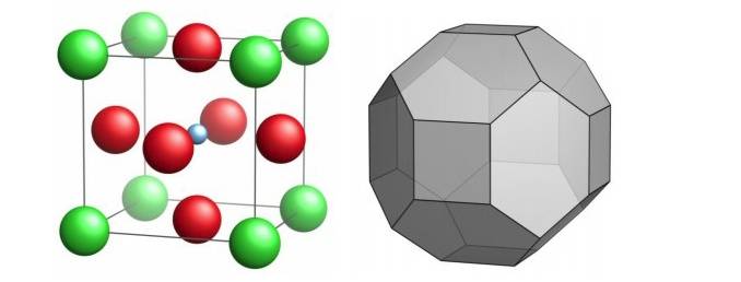

I would love to get help on this particular question that I find extremely difficult to answer.
-"Bariumtitanate can under a certain set of conditions crystallize in the given structure. With the help of the compounds symmetries, explain how it is possible for it to achieve such a crystallization structure.
No equations are given for the specific problem so I am leaning towards that one has to use translation/reflection symmetries etc. to be able to solve this specific problem.
The given crystallized structure (transparent octahedron shape) can be seen in the picture.
It might help to label the species in the picture and then think about what happens if you try to move the center ion out of its place.
I believe that this species has undergone translation from either heat or cooling, which in turn has moved the Ti-ion (center ion) and caused the hexagon-shaped face to appear. Because from the start, the Ba2Tio species has a unit cell of a perovskite, which in turn is ideally face-centered cubic I believe. But I don't know how to translate this into "symmetry words", so to say..
What do you mean by translation? Do you mean the Ti4+ has moved to the center of an octahedron?
If you start with the cubic crystal structure in the picture you attached, what happens when you move the Ti4+ away from the center?
