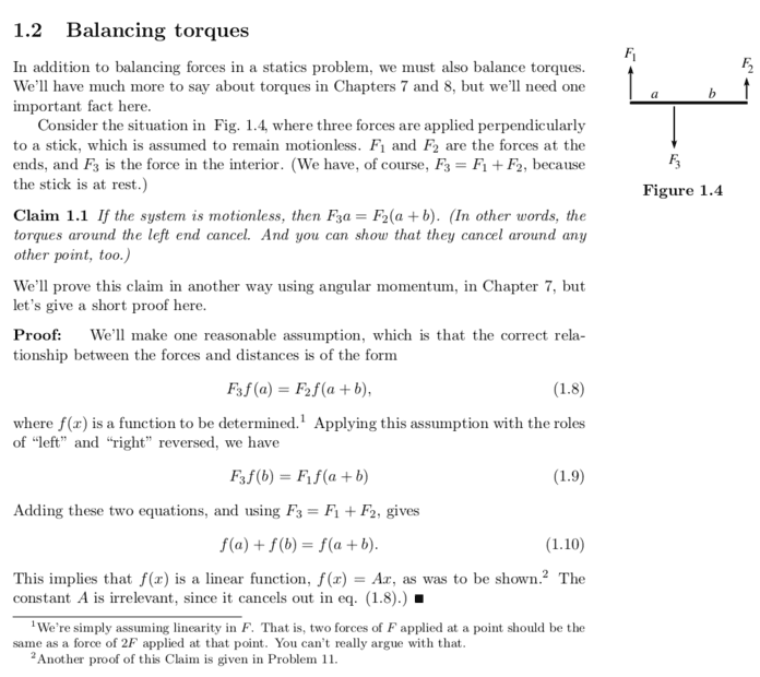

Please refer the image below.
Newton's Laws
I have been trying to understand this proof from the book 'Introduction to classical mechanics' by David Morin. This proof comes up in the first chapter of statics and is a proof for the definition of torque.
I don't understand why the assumption taken in the beginning of the proof is reasonable. A note given at the end tries to give some clarification, but I can't relate these 2 points.
Please be kind to help. :)
How about this:
The "effectivity" of a force of magnitude F applied in a specified direction at x from the axis is ##g(F,x)##. Applying some multiple of F, ##\lambda F##, in the same direction and at the same point should have effectivity ##\lambda g(F,x)##, i.e. ##\lambda g(F,x)=g(\lambda F,x)##. Hence ##\frac{\partial g(F,x)}{\partial F}=\frac{\partial g(\lambda F, x)}{\partial F}##. Since every force in the specified direction can be represented by a suitable choice of ##\lambda##, this implies ##\frac{\partial g}{\partial F}## is a function of x only. Integrating, ##g=F f(x)+c## for some function ##f##.
Adding that a zero force should have zero effect leads to the result.

Sorry, but I don't quite understand the partial differential equation, @haruspex . Should'nt there be a ##\lambda## on the left.
Sorry, I didn't write the algebra correctly.
##\lambda g(F,x)=g(\lambda F,x)##. Hence ##\lambda\frac{\partial g}{\partial F}\vert_{F,x}=\lambda\frac{\partial g}{\partial F}\vert_{\lambda F, x}##.
Cancelling,
##\frac{\partial g}{\partial F}\vert_{F,x}=\frac{\partial g}{\partial F}\vert_{\lambda F, x}##.
Yes sir, I understood it now. Just to check if I got it properly, I'll try to summarise here. The 'effectiveness of rotation' of a force, taken as ##g(F,x)## is a function of the force F and the distance from the origin x. If the force be scaled by ##\lambda##, the effectiveness ##g(F,x)## must also be scaled by that factor. This implies that the change in effectiveness per change in F just depends on x (and not on the particular value of F). Therefore, effectiveness itself is a linearly dependent on f and some function of x. I might have lost some rigorousness here due to departure from mathematical notation, but I hope I have understood the idea properly.
I also wanted to correlate the assumption with the note 1 given at the end. From your explanation, ##\lambda g (F,x) = g (\lambda F, x)## means the same as the note, right?

Yes, you get the idea.
My explanation is an attempt to use the hint to arrive at the answer. Whether that's what the author had in mind I cannot be sure.
