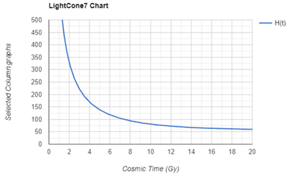

The general form of Hubble’s law is given by, v = H(t)D, where v is the recession velocity of an object, D is the object’s proper distance from our location, and H(t) is the Hubble parameter at cosmological time t. The value of H(t) at the present time, H(now), is called the Hubble constant. Some people consider this term as a misnomer because H(t) is t-dependent. Let’s plot the H vs. t curve with Jorrie’s calculator and discuss the result. We can share our understandings and questions.
The general form of Hubble’s law for a given cosmological time t is given by,
v = H(t)D, (1)​
where v is the recession velocity of an object, D is its proper distance, and H(t) is the Hubble parameter at t. To get the H vs. t plot based on the ΛCDM model, we can use the following steps:
  • Keep the default values of z(upper) and z(lower).
  • Click Open Column Definition and Selection, keep only Cosmic Time and H(z) selected, and click Open Column Definition and Selection again to close it.
  • Select Chart and click Calculate. The H vs. t plot will appear.
  • Note: You need to use Open Chart Options to adjust the ranges of the x- and y- coordinates to get the following plot:
Line graph titled LightCone7 Chart plotting H(t) in km/s/Mpc against cosmic time in Gy from 0 to 20; H(t) falls steeply from above 500 near 1 Gy toward about 60 by 20 Gy.
As can be seen from the above figure, H(t) had very large values during the early times of the universe. We can use Jorrie’s calculator to get the following values (1 pc = 3.26 light year):
Table of Hubble parameter H in km/s/Mpc against cosmic time t in Gyr: t 0.000372 gives H 1560000, 0.5 gives 1301, 1 gives 652.3, 5 gives 138.3, 10 gives 80.63, 13.8 gives 67.74 (highlighted), 20 gives 59.98.
For the present time, the Hubble law becomes,
v = H(13.8) D = 67.74 D, (2)​
where H(13.8) = 67.74 km/s/Mpc is called the Hubble constant. This is probably because Eq. (2) is applicable for all D values at the present time. As an example, we can calculate v for an object near the edge of the observable universe, D = 46.5 Gly. Eq. (2) gives its recession velocity as v = 3.22 c.

@JimJCW
It is "constant" in that it doesn't depend on direction or location. All parts of space should obey that simple law regardless of which point in space you want to measure v and D from.
The change with respect to time is slow - by human standards. It would not have been obvious when the recession was first observed.
That's all I ever imagined when H was referred to as a constant.
I think we all agree that the Hubble parameter H(t) is not a constant; it is t-dependent. Calling H(now) = 67.74 km/s/Mpc the Hubble constant, however, is considered as a misnomer by some. Your explanation in that case makes sense.

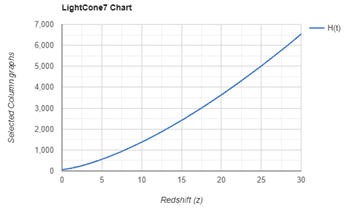

Let’s plot . . . with Jorrie’s calculator and discuss the result.
Let’s make more calculations about the Hubble parameter. To get the H vs. z plot based on the ΛCDM model, we can use the following steps:
  • Start Jorrie’s calculator: http://jorrie.epizy.com/Lightcone7-2021-03-12/LightCone_Ho7.html?i=1. It uses PLANCK Data (2015) as default input.
  • Set z(upper) = 100 and z(lower) = 0.
  • Click Open Column Definition and Selection, keep only Redshift (z) and H(z) selected, and click Open Column Definition and Selection again to close it.
  • Select Chart and click Calculate. The H vs. z plot will appear.
Line chart titled LightCone7 Chart showing H(t) rising from near 0 at redshift z = 0 to about 6,500 at z = 30, curving upward more steeply at higher redshift.
We can use Jorrie’s calculator to get the following values:
Table of Hubble parameter H in km/s/Mpc at redshift z: z = 0 gives 67.74, z = 1 gives 120.5, z = 5 gives 556.7, z = 10 gives 1377, z = 20 gives 3635, z = 50 gives 13820.

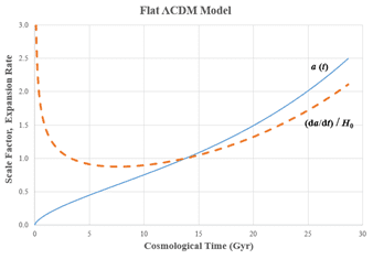

You brought up an interesting expression,
Equation H(t) = ȧ(t)/a(t), where H(t) is the Hubble parameter, ȧ(t) is the time derivative of the scale factor a(t).
The a vs. t and da/dt vs. t plots are shown below:
Graph titled Flat ΛCDM Model plotting scale factor and expansion rate against cosmological time in Gyr from 0 to about 30. A solid blue curve a(t) rises from near 0 to about 2.5, and a dashed orange curve (da/dt)/H0 falls from very high values near 0 to a minimum near 1 around 7 to 10 Gyr, then rises to about 2.1.
Since both a(t) and da/dt increase with time, one may want to know whether H(t) decreases or increases toward the future. As can be seen from the first figure of this post, it continually decreases with time and approaching an asymptotic value determined by ΩΛ, as a(t) becomes large,
Equation for the squared Hubble parameter H^2(t) = H_0^2 Ω_Λ + Ω_M (a_0/a(t))^3 + Ω_R (a_0/a(t))^4 + Ω_k (a_0/a(t))^2, with a(t) the scale factor.
H(∞) is calculated to be 56.3 km/s/Mpc using PLANCK Data (2015).
